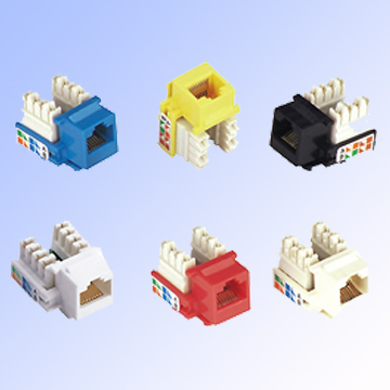

All right, but what do you usually punch down to on the camera end when the camera has an RJ-45 jack instead of a punchdown block? A keystone jack, as I did, or something else?
Yes a Keystone jack. I try not to ever do field terminations of RJ45s unless I have no choice.
I punch down a keystone jack and use a factory terminated patch cable from the jack to the camera.
This is by FAR the best and most professional approach. I stopped collecting all the "but I'm a pro and have been doing this for years" hack RJ-45s I've cut off and replaced with keystone jacks to fix cables that couldn't perform to spec.

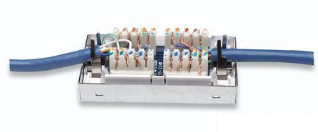

Old habits dye hard and I like the idea of an access point in a junction box adjacent to the camera housing, using an IDC junction gives that access. As I've said a thousand times before, there are a million ways to skin a cat. Poor Cat!
We do a lot of Panduit terminations and they are a lot better than punching down a keystone jack, less punching holes in your hand bad punchdown blades etc. Panduit and others make a weatherprooof jack housing. I have to come down on the side of not making your own patch cords. factory made are just too cheap to fool with them.
