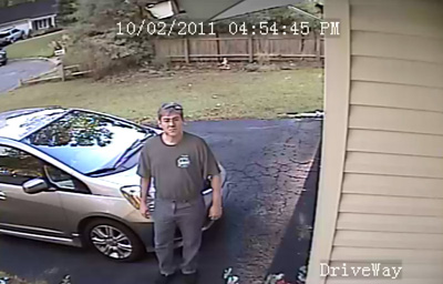

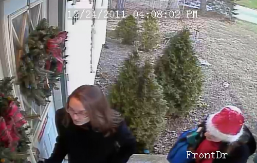

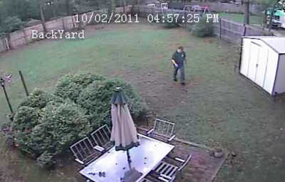

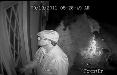

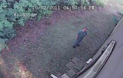

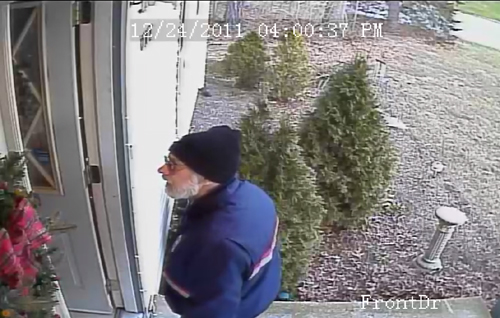

Far as cameras, get good ones but I have found good doesn't always mean hundereds of dollars per camera. Pictures are worth a thousand words. Here's some from my cameras, not one of them over 80 bucks and still going strong-
Front door, TDN with WDR & IR
Other bullet cams-
You get the idea. All analog system and aside from the obvious wide shots, ID'ing is fine. I'm not saying don't get the best cams you can afford. But 2,400 bucks on cameras for an 8 channel system may not be needed. Take a look at my vids for my 8 channel setup. The system is clearer than the compressed vids, but you'll get the idea. The front door camera in the vid has been swapped out for the one I took the snap shots of above. Everyones eyes probably roll when I always jump into threads like these with my pics- lol! I'm an example of a modest budget doing the job, that's all. For perspective. Best of luck to you!
