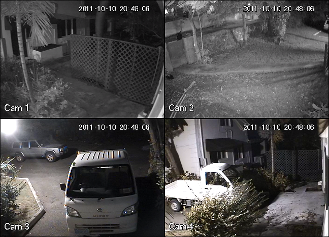

Really I believe you and tom are just so used to seeing cheap color IR cameras that it has twisted your perspective of built in Infrared. And I would agree, cheap IR cameras rarely have enough IR to fill the width of the FOV for outdoor applications, in a small room or office, no problem at all though.
These are all cameras with Built in IR ...
Shows comparison from cheap 4mm color IR to TDN IR with 2.8mm lens.
Notice the bottom left which is a 3.8mm lens, the IR covers the entire FOV, $100 camera.
Notice only one that really has any black on the sides is the 2.8mm and thats a given as that is around 110 degrees.
No IR spots here ...
Wow this one is a 10 year old IR camera ...
Amd just for grins and giggles, $40 IR domes in a store with no lights at night.
They are just that cheap, they are NOT going to add lights and run the power needed for that.
cheap $40 color IR even lasts well through the hurricane

BTW this is my yard, and nobody can tell me I dont need IR - in 2 camera locations I DO NEED IR.
I have used all the latest and greatest here, the monalisa, heck even the BW exview bullet .. and IR it is if I want any kind of moderately clear video at night ... btw all cameras I got for free/used/broke then fixed ... the top right IR is actually a TDN IR bullet with a $400+ Extreme EX26LED. I got it for free, so might as well flood that area. I wouldn't mind installing a nice big light there, but my landlords wont let me, and I cant afford to to it anyway - electricity is expensive these days also. Note the cheap color only bullets where there is alot of light.
oh yeah, monalisa without IR .. in BW mode (not day night mode).
Monalisa with IR .. see .. now i can see the criminal.
