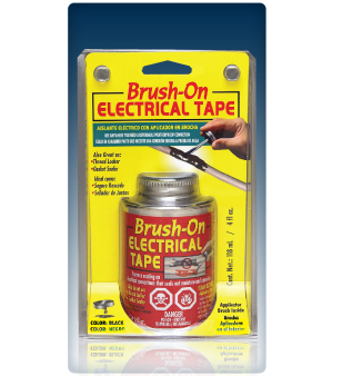

oderus1671 0 Posted January 6, 2012 thanks for all the advice, i will start this weekend with the connections at the camera, as they are exposed to the elements. then i'll look at swapping the cameras around to see if the cable or cam is bad. if it happens to be the connectors at the cam, what would be a good way to weatherproof the connections? currently i am using a product called "liquid electrical tape" or something to that effect. thanks! Share this post Link to post Share on other sites

Soundy 1 Posted January 8, 2012 I got the issue figured out. Apparently, the BNC connector had a bad seal against water, and there was a slight amount of corrosion on the outer part of it. After a bit of scraping and fine sandpaper, I plugged it in and its good as new! " title="Applause" /> So next trip to town I will get some new sealant for all the connections just to be safe. What do ya'll use for sealing your connections? Most compression connectors are designed to be weather-tight. Get some dielectric grease, commonly sold at auto parts stores as battery post grease or at RV shops for putting in trailer wiring connectors, and put a bit of that inside the connector (both when assembling it, and where the two fit together). Give it either a tight wrap of *quality* electrical tape, or use some of this: Share this post Link to post Share on other sites
