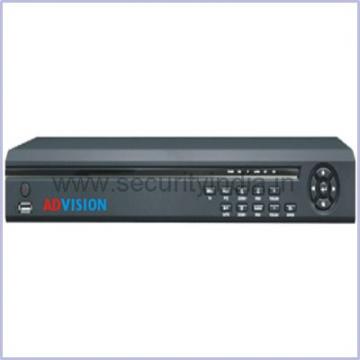

pkfonline 0 Posted February 3, 2012 Sir, Dvr Make is ADVISION. I am trying to operate the DVR thru IP KVM, But mouse is not working. My Ultimate aim is to operate DVR's Mouse. Help would be much appreciated. Thanks PKF Share this post Link to post Share on other sites
