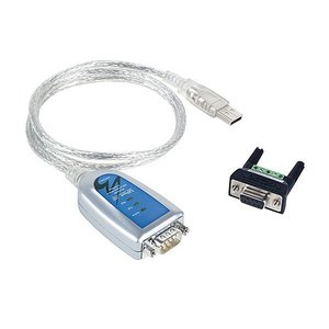

Hi Sean we use usb to rs232 for POS and we found it is always best to use a software based rs232. this then allows you to open and keep a com port. which is ideal for adding POS or PTZ via usb.
we have been using moxa if you can wait 5 to 6 days i will send you one free to try.
