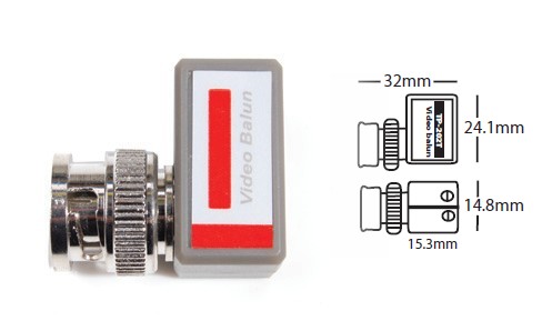

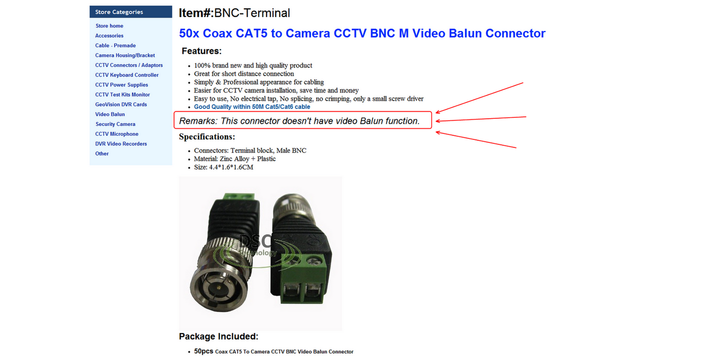

coreyman 0 Posted January 10, 2012 tomcctv said: hi. in your posts you mention baluns at camera but at wall end you have a BNC plate via keystones. were is your dvr balun ?? Here they are, http://www.ebay.com/itm/220817752614?ssPageName=STRK:MEWAX:IT&_trksid=p3984.m1423.l2649#ht_1908wt_1163 they are inside the wall on the other side of the bnc keystone connected to the cable. They also do not appear to be 'actual baluns'. Share this post Link to post Share on other sites

sinbad 0 Posted January 11, 2012 good balun cost $20-30, you paid .68 cents EA. that your problem. IMHO these 'baluns' look like the simply convert your BNC (+)&(-) to screw terminals, i highly doubt there is any capacitor under that mold. then you runing the signal over cat5... Share this post Link to post Share on other sites
coreyman 0 Posted January 11, 2012 sinbad said: good balun cost $20-30, you paid .68 cents EA. that your problem. IMHO these 'baluns' look like the simply convert your BNC (+)&(-) to screw terminals, i highly doubt there is any capacitor under that mold. then you runing the signal over cat5... Yes that is the prOblem I did not realize cat5 had a higher resistance. Share this post Link to post Share on other sites
