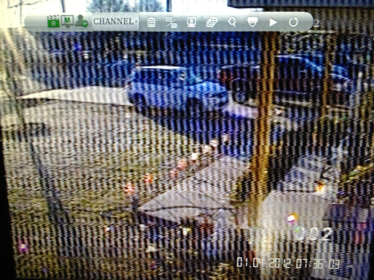

So during the night everything works great. But as soon as it turns daylight around 6-7am in the morning it starts to get these jagged vertical lines on the screen.
These lines will last all day until right around the sun sets about 5pm. I also have done a factory default reset checked all the timers and schedules.
Also If the camera is unplugged at night and left off till the middle of the day and then you plug it in it will instantly have the same jagged vertical lines.
Here's the best video I have of right as it starts in the morning. http://youtu.be/Uj32Suu_0Hc

Update: This morning , it isn't has bad has in the picture. but you can still tell there's some kind of interference.

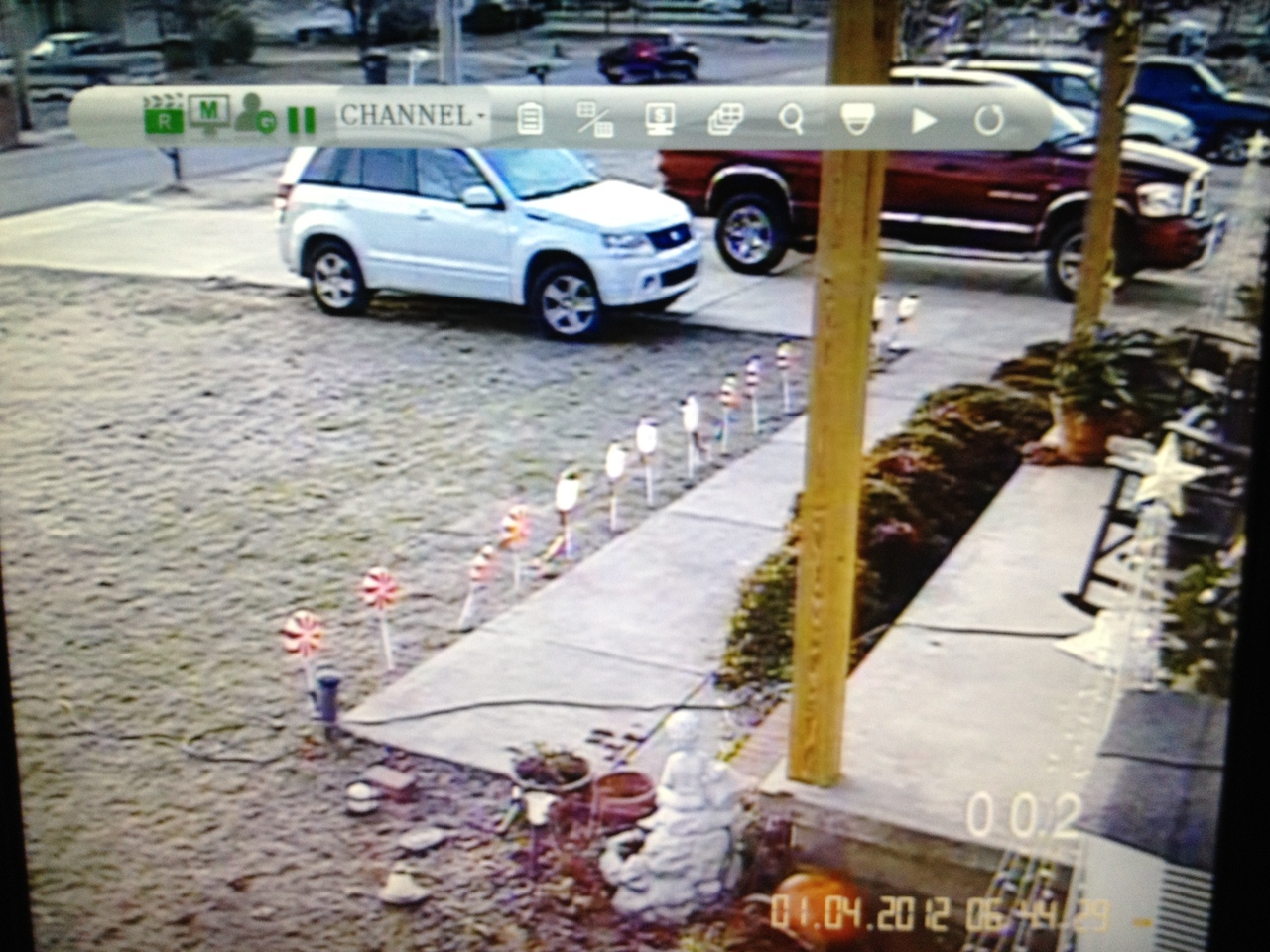

Here's a picture right before it does it.

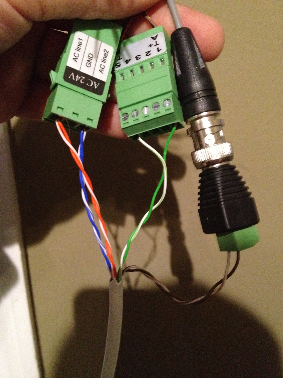

So I ran the power separate and I still have interference.
Only thing through the Cat5e is the Video and Rs485.
Power is in a separate 18/2 cable.
Next thing I tried is running just a normal BNC video cable separate from the power and rs485 and bingo! No lines no nothing clear as a bell!

its because you did not run baluns when using cat5. BNC =75ohms cat5 =100ohms fitted balun = 75ohms (at both ends)

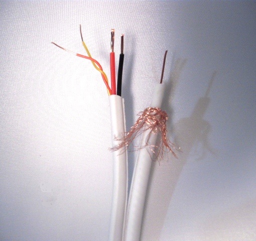

Maybe this is just one of those jobs where it would be easier to use siamese with seperate wires. Or use something like this:
It seems that every week someone is having problems with cat5 installations. Not saying that its an inferior way of doing things at all, but maybe for one time installers who are not proficient with these things, it would be a better option to use siamese.

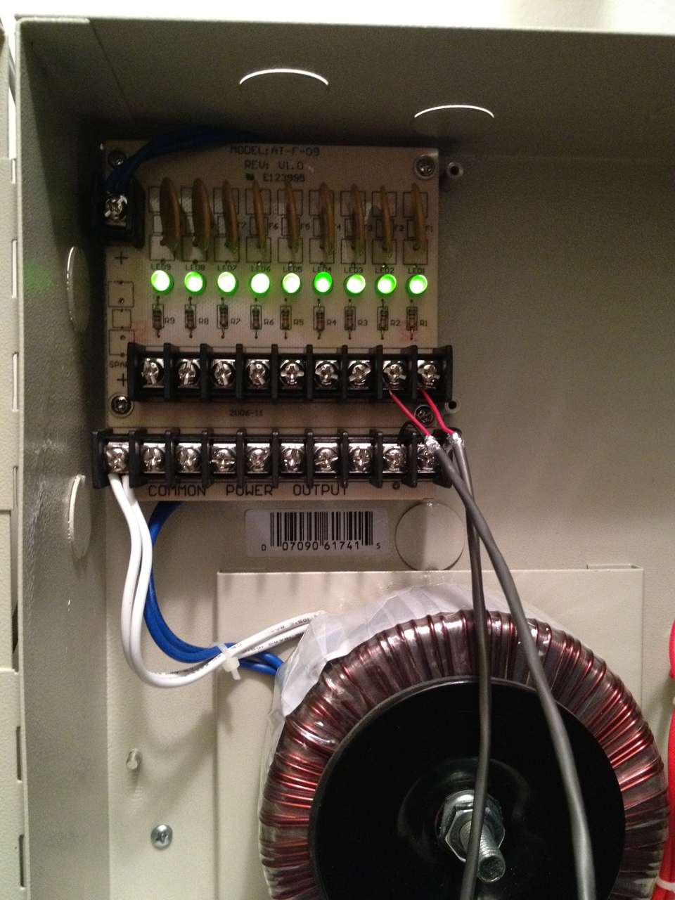

Gee we've run 24V AC over cat 5e for years. Don't think that's your issue... In fact we use 24V AC mostly because of ground loop issues we tend to find at times using DC.

Apart from the lack of baluns, the original poster has also mis-wired the 24vAC. They need to connect the blue and orange wires to one phase of their 24v supply, and the remaining white wires to the other phase. If they do this, the twisted pairs will cancel out the interference from the AC supply.

I've never done it this way, and it's never been a problem - I use blue and blue/white for video, orange and orange/white for DC+ or AC hot, and green with green/white for DC ground or AC neutral.
No worries. I consider the 24vAC to be another signal, so reckon that it may as well go down a pair to minimise crosstalk. The lack of baluns is the real killer here.
The problem here is twofold. First by not using baluns there is an impedance mismatch
( 75^/100^ ) This results in an unbalanced transmission path & causes loss of the noise immunity that is characteristic of twisted pair. Now if the ONLY problem was the impedance mismatch then the result would more than likely be a phasing problem (ghosting). The interference displayed in the picture is typical of an external electrical interference getting onto the transmission path because of the reduced noise immunity created by the impedance mismatch ( lack of baluns ). The other clue is that the interference is only there during the day
