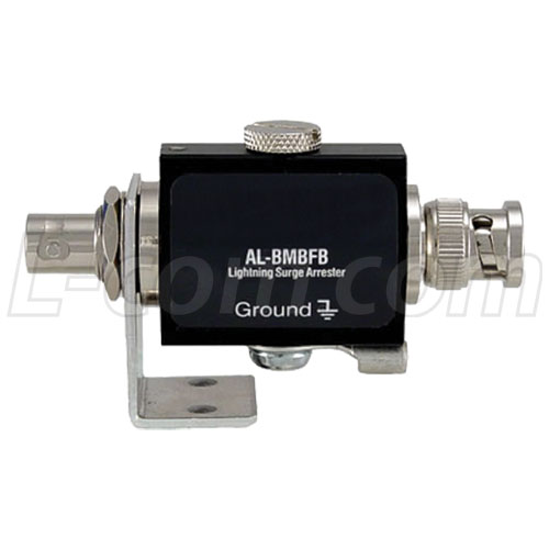

ssnapier 0 Posted January 17, 2012 You could always put lightning traps on each channel, but the key to any sort of protection system is a good (tested and verified) ground. Here is what the lightning trap looks like, they typically cost between $15 and $40 depending on size: Share this post Link to post Share on other sites
PaulsonLaw 0 Posted March 1, 2012 nice inline surger btw! Sounds like you cooked those channels... The good new is you can buy a newer DVR w/out a HD on the cheap. EXP is a Zmodo & Provantage has a 16ch system, no HD, for $220usd. Also, see my post, "GFI that DVR" as I just had a pole get hit the other day & all is well.... Good luck.... Share this post Link to post Share on other sites
SEANHAWG 1 Posted March 2, 2012 yeah it doesnt matter what DVR you have, if you receive a surge up the coax, its gonna fry those channels. Putting surge protectors on each channel at the head end like ssnapier showed will help. Share this post Link to post Share on other sites
