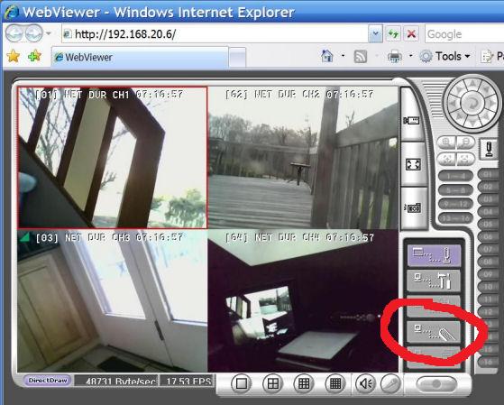

tomcctv 190 Posted January 15, 2012 once webviwer is loaded click on second icon up and the system will load remote viewer to your pc and insert a icon onto your desk top. so its always there. then it gives you same screen as your dvr. port 80 web viewer. and you also need 5550/56/1056. if you want to use iphone/ ipad/ android / BB / and the free ddns service Share this post Link to post Share on other sites
