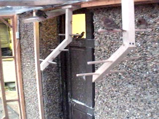

Hi again folks, I'm still having problems. I got my brother to check if he could see my camera feeds and he is also asked to install software. I don't think this is right is it? I want to be able to allow guests to log in to watch the birds while they are nesting etc and not have them asked to install software. I have the server switched on and I have one camera on the system at the moment, this is my address http://87.194.185.249 can anyone tell me what I might be doing wrong?
Thanks
John
Thanks Tomcctv, that is a relief. I was going mad, trying to work out if I had missed something. Was that streaming video or just a still? I assume as I add more cameras to the system, guest will have a choice of which to view?
Cheers
John
Cheers
John
hi. yes it was video ... i just used the snap shot to take a still. yes there is options to view other cameras when added.
the active x for your users is only for first time login. after that it will go direct to footage for them.
