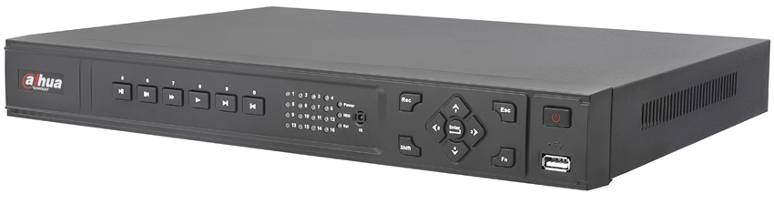

Another thing to look at though ... the image they have for that DVR is NOT the Dahua HF-A.
This is the HF-A
This is the HF-A
What model is in the pic ? and do u rate it over the model for sale in that link ?
THAT pic is the Dahua HF-A model.
Sometimes the front panel can differ as they customize it for various brands, but the image in the link you posted is a picture of the LE-A / LE-AS/AN / HE-AS/AN
