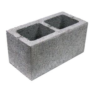

Why not just add some weight?
8x8x16", 28-30lbs., $1.25 at Home Depot... put two or three of these in the bottom of the kiosk and it's unlikely to walk off OR tip over. Add a tracker in the off chance someone decides to bring a hand truck...
I would agree with this, it would appear that the main concern is the weight, for both safety and security. If you can remove that vulnerability then you can remove the tip/theft danger somewhat. Although not in the security industry our business does have lightweight portable items that are of value to our business, if they cannot be secured to the floor, the they are made heavy.
