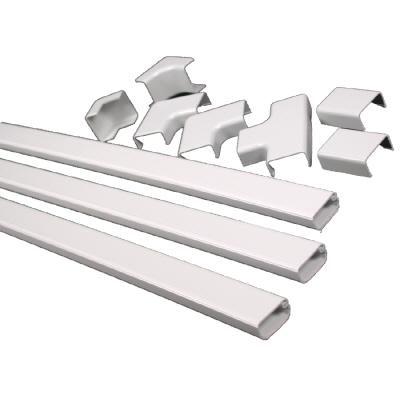

Soundy 1 Posted January 22, 2012 Electrical... or building supply. Got a Home Depot nearby? Lowe's? Even some plumbing shops may carry it. This is the stuff: Share this post Link to post Share on other sites
troy6363 0 Posted January 22, 2012 Ok. what is this made out of? plastic? Is it rated for outdoor use? Can I run it into a junction box? Share this post Link to post Share on other sites
rory 0 Posted January 22, 2012 Had them outside for 10 years at one house on the ocean. They aren't water sealed though if that's what you mean. Share this post Link to post Share on other sites
Soundy 1 Posted January 22, 2012 Nope, not watertight, but they will provide pretty good protection from the elements as long as they're not in direct rain. Actually, depending on the style you get, many types are "hinged" and putting the hinged edge up on a horizontal run should keep rainwater from getting in. Share this post Link to post Share on other sites
