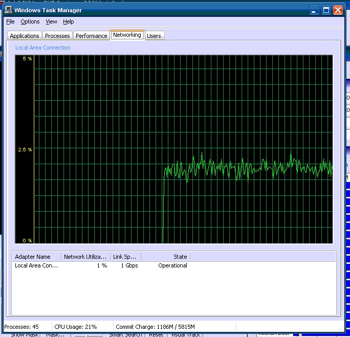

Soundy 1 Posted January 23, 2012 ssmith10pn said: And I do believe ISCSI requires a dedicated Ethernet port. It does not. I direct you to my standard setup for the client using these systems: The RAID in this case (Promise and Enhance units) has separate iSCSI data ports and management port - you can't access the management console from the iSCSI interface - but others (QNAP, Synology) do both iSCSI data and management through the same port. hardwired said: Avigilon (and Exacq, and some others) need direct block-level drive access (direct attached or iSCSI), versus file-level storage (what most standard NAS devices provide), because they need high speed, direct drive access to directly archive to. The reason given to me for Vigil not working with SMB shares is that they're not reliable enough in reconnecting after a system restart... which in my experience, is certainly possible - I've had more than a few instances of network drive shares not reconnecting properly after a reboot. But your explanation makes sense too Share this post Link to post Share on other sites
ssmith10pn 0 Posted January 24, 2012 My main concern with the ISCSI on the same port was bandwidth. If you have 250Mb of incoming data and all your cameras see motion at once you also have 250Mb going out to the ISCSI. Not including the client data. Sure is a lot easier to throw in a second NIC and segregate the ISCSI data. Or in the case of an Avigilon server you have 4 NICs and you team 2 for incoming camera data and team 2 for outgoing ISCSI. Or in our case scrap that idea and go HBA. which are 4Gb minimum. Share this post Link to post Share on other sites
Soundy 1 Posted January 24, 2012 ssmith10pn said: My main concern with the ISCSI on the same port was bandwidth. If you have 250Mb of incoming data and all your cameras see motion at once you also have 250Mb going out to the ISCSI. Not including the client data. Granted, although it's going to take a pretty big install to hit that... in any case, that's a system-dependent design consideration; my answer remains the same: iSCSI *does not* REQUIRE a separate NIC. Again, this is the load on the single NIC in a system running 28 H.264 cameras at D1, and three 2MP H.264 cameras, all recording to an iSCSI array, all with plenty of activity: Share this post Link to post Share on other sites

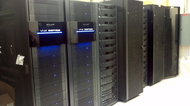

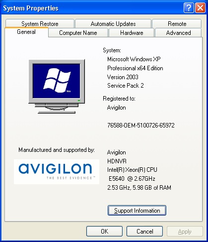

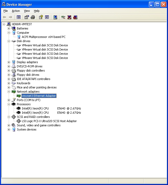

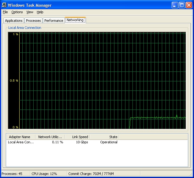

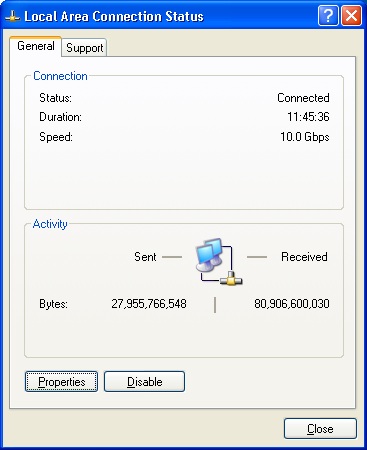

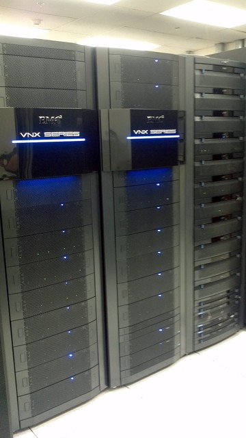

ssmith10pn 0 Posted January 27, 2012 Just wanted to throw some eye candy in the mix. Share this post Link to post Share on other sites
thewireguys 3 Posted January 27, 2012 ssmith10pn said: Just wanted to throw some eye candy in the mix. Nice!! What nic card are you using? Share this post Link to post Share on other sites
hardwired 0 Posted January 27, 2012 thewireguys said: ssmith10pn said: Just wanted to throw some eye candy in the mix. Nice!! What nic card are you using? And, what server are you using that's able to handle 1.1Gbps of traffic, at 12% CPU?Tech porn, again! Share this post Link to post Share on other sites
ssmith10pn 0 Posted January 27, 2012 I think the IS guys were having a little fun today. Share this post Link to post Share on other sites
ak357 0 Posted January 27, 2012 ssmith10pn said: [/ I wondering how many Dahua DVR this rack can hold I will have to call my friend in Bahamas Share this post Link to post Share on other sites
