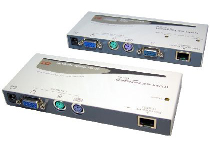

Hi. hdmi does not have a very long distance you can buy extenders but with mouse control they get expensive.
another way is VGA KMV with mouse and keyboad control. if you have vgs on both your dvr and tv (might be listed as pc input) then you just need a cat5 cable between them both and a KVM at each end.
