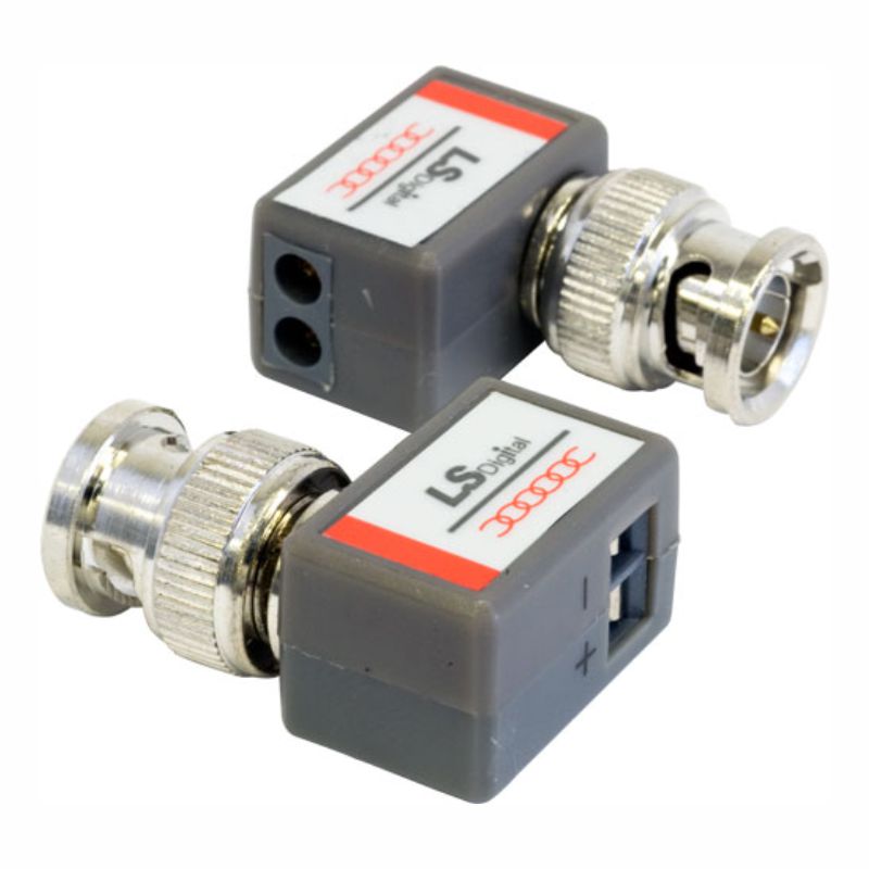

yes that is ok to do. and on the coax you need a BNC on each end. if you dont have the tools to strip the coax and to crimp then i would look at screw on BNC connectors.
or another way is to not use your coax and just use your cat5 do the same as before but the blue and the white with blue stip keep that pair from the rest and use a balun for your video.
this is also the best way if you have not done Coax connections before and saves on buying the tools that you may not use again.
this is what a balun will look like ( lots of connectors going around that say baluns but are not)
you would put the blue cable into the + and the white / blue into the -
