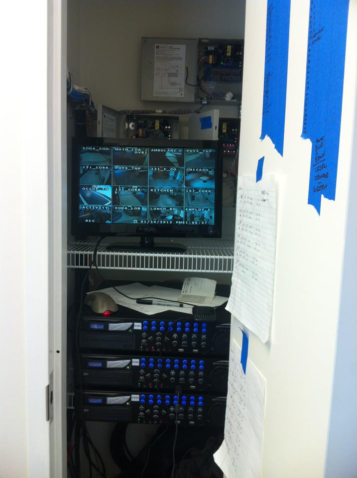

I am at a total loss here. My background is in commercial electrical but have installed 3 camera systems so far.
My current issue is on a new install, 44 cameras. I have 3 power supplies (altronix sav18d) which are designed for CCTV, and 3 DVRs. Wiring is all cat 5, minus 2 outdoor cameras. We ran 2 cameras on 1 cat 5. Done it in the past without issues. 1 pair for power, 1 for video for each camera.
The problem: horizontal lines.
Solution 1: twisting 2 power pairs together for the cctv power supply.
Solution 2: using a 12 volt computer monitor power supply on one pair
I have not needed to do this before. All runs are less than 400 feet, some less than 200 and I have issues. I have tried EVERYTHING. Grounding is spot on, I've tried different power sources unhooking other cameras, etc etc. The only solution I have found that works is twisting two pairs together. That is fine, but building is complete and not easy to run 20 extra cables now.
One thing I tried before twisting 2 pairs together was a different 12V source- I used a 12VDC video monitor power supply and tried it instead of the CCTV power and the picture works fine...with ONE PAIR for the power. How can I use 1 pair on that power supply, but a dedicated CCTV power supply I need to twist the pairs together? I would say it was a bad CCTV supply, but all 3 do it. I brought in an old power supply and had similar issues with wavy lines. Could the problem be the power supply in the end? The sav18D doesn't look like a real great unit, but is designed for this application.
Would appreciate any insight. Thanks for the help.

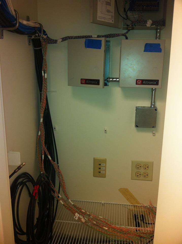

The power and video feeds were split at the head end/camera closet. Within one cat5e cable there are 2 power pairs being used and 2 video pairs being used. Roughly 16 cameras from each dvr/power supply.
Power pairs are ran into the power supplies, and into the camera on the cam end.
The video pairs have a Balun on camera side and DVR side. Baluns are models: (gem) BLN-TL and COMELIT-CNTB. It shouldn't matter if different baluns are used, correct?
Grounding- All power is in conduit here. Originally I had everything bonded to the box/conduit system. Then I tried building steel. Last resort was running a ground wire back to the panel- no differences were seen in either. I am getting <.2 ohms from conduit ground to steel and <.1 ohms when I tested to building water supply nearby. IMO, grounds are solid and not the issue...especially with ground wire to panel run.
