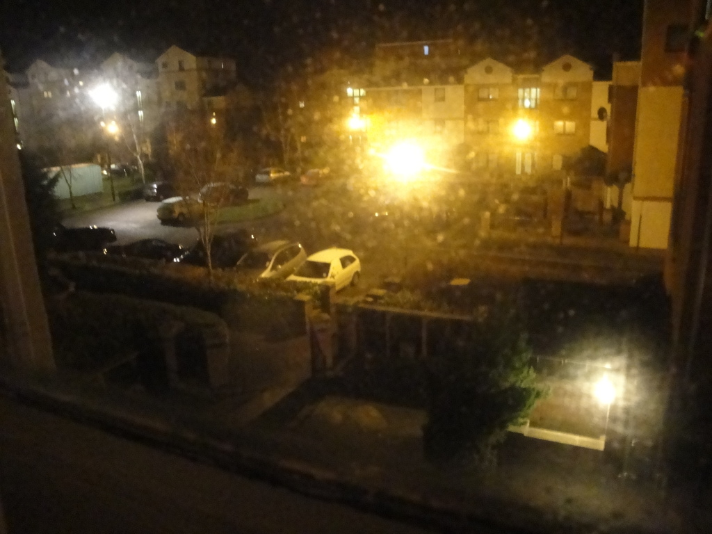

vitos 0 Posted January 27, 2012 hi vitos. we will need a bit more info to your problem. how are they smashing your windows. are they comming upto your car or using something away. how close is your car to your house. and what is your budget and location. I can see my car from kitchen window, which is great spot for camera and can see hole car park. Yes they coming up to my car and smashing door window, same window twice. First time on 15 December, when i was going holidays, then i came back on 3rd January. I did change parking place away from pedestrians footpaths. Then again smashed my window this tuesday 24jan. Iam looking for camera that can be connected to PC for recording. Or maybe its better to buy with separate recorder!? Budget would be around 130£ Kitchen window is dirty Share this post Link to post Share on other sites

vitos 0 Posted January 28, 2012 Thanks for advice. My car is white one with white patch and its looks in picture quite far away. Iam living in Edinburgh Share this post Link to post Share on other sites
tomcctv 190 Posted January 28, 2012 a foscam is infact just a web cam. you will get no detail at all with there 6mm lens infact you will not even get an image like your picture posted. and you cant get detail from that. Share this post Link to post Share on other sites

vitos 0 Posted January 30, 2012 Can any of foscam cameras can zoom in a bit? Am pretty sure who ever smashed my window twice, will do third time. Am sure it is neighbour or someone next house. As long i can see from where he coming from and what time. Then police can deal with that. The car from my window is about 15 meters. Share this post Link to post Share on other sites
tomcctv 190 Posted January 30, 2012 Can any of foscam cameras can zoom in a bit? no with a foscam. (the picture you have posted is better than a foscam) from your window to your car you are looking at a 50-75mm lens if you want to get detail like a face shot. you may be better using a camcorder Share this post Link to post Share on other sites
