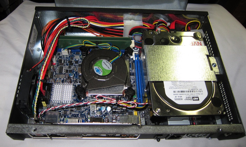

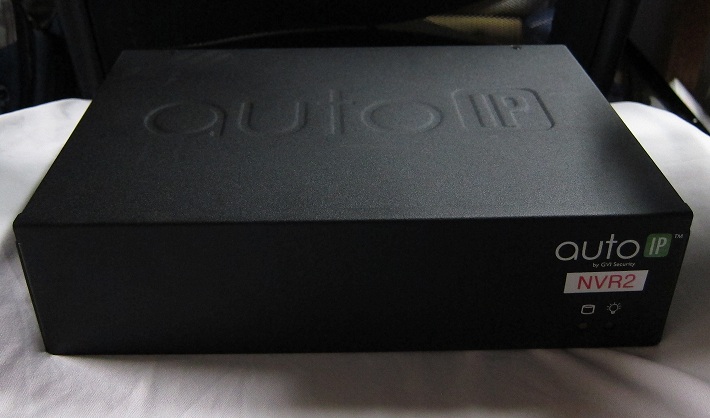

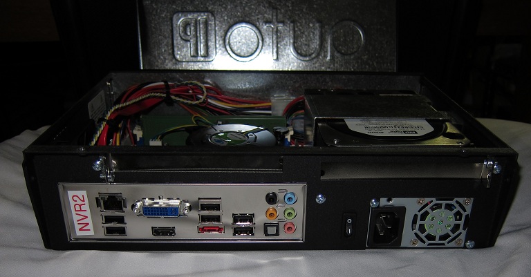

MaxIcon 0 Posted January 29, 2012 If this is inappropriate, let me know. I'm not associated with these guys, but this is a great deal on a standalone PC NVR for those who don't mind supporting their own gear. I've been running Blue Iris 3 on a GVI autoNVR that's essentially an i3 mini-ITX box with Windows Embedded 7 installed. Currently I've got 2 Vivotek IP8332s (1 MP ea), one Vivotek FD8134 (1 MP), an Arecont AV5100M (5 MP), and a Y-cam Black (VGA), and am running about 40% CPU with all of them at 5 FPS except the Y-cam at 15 fps. When I connect my Messoa NCR870 2MP, it bumps up to about 60%, but BI has a hard time with the Messoa decoding and scrambles it. These boxes are being blown out on ebay for about $270 in most auctions, and come with the following specs: - Core i3-540 CPU - Intel DH57JG motherboard (also supports i5-6XX cpus) - 2 GB RAM (can upgrade to 8G) - 2 TB hard drive - Windows Embedded 7 - No-frills case, with no front panel controls except a few LEDs, and no room for more HDs or to install a PCIe board. I got it on a whim, and don't care much for the GVI software, but was surprised to find that BI3 runs fine on it as-is, so I don't have to install Win7 on it as I had planned. I disabled the GVI services so they wouldn't use up resources. Anyway, this is a great little super compact box, perfect for a headless NVR system, and power usage is low. GVI is out of business, so there's no support, but everything except the case is a standard off the shelf item. Search AutoNVR on ebay to find them. He adds more every few days, so don't get into bidding wars and pay too much! I'm not associated with the seller, but have bought several more of these because I couldn't build them for the price I'm paying. The next one's going to be a Windows Home Server 2011 box. There's also a GVI box called the Razberi being sold that's an all-in-one NVR with 8 POE ports, but it's not standard hardware, and runs Windows Embedded XP (much more primitive). Camera support is limited, software's a bit buggy, and the lack of support makes this one not so recommendable unless you want something to play with. Share this post Link to post Share on other sites

MaxIcon 0 Posted January 30, 2012 There's always a risk buying on ebay, of course, but some deals to be had as well if you use judgement. I'm a pretty serious PC geek, and this looks legit to me. I'd normally avoid an orphan NVR, and that's probably keeping a lot of people away. These are new in box, unopened, but no warranty, and the seller has a DOA guarantee. I bought one to check it out. Once I saw it's just a simple PC, nothing custom except the case and apps, I bought some more. You can't buy the individual parts for this, and I need a few simple PCs to update some old P4s, as well as some big HDs. The motherboard's a very good standard model Intel board, not fancy, but good performance and very reliable, if a little outdated (only Clarkdale dual core support, no Sandy Bridge). The HD is not a common model, but it's a WD 2TB AV hard drive (WD20EVDS), so it's not much different than the chances you'll take with any similar HD. List price on these was $6k, and the few places that still list them have them in the $3k range. Yes, I know, nothing sells for list price, but it was being pushed as a quality piece of gear, and the build quality feels very good to me. The autoIP software includes 16 cam licenses, and the software's not bad, but buggy and never likely to be fixed. It likes most of my ONVIF cams pretty well. So far, I can't tell the difference between Windows 7 and Windows Embedded 7, though I'm sure it's there somewhere - it's not all stripped down like Windows Embedded XP usually is. The vendor had a bunch up at once at first, which probably kept the price down. It's been creeping up as people find out about them, and he's started putting a few at a time on. I've seen several people buy 4-6 of them, probably for the same reason I am. Dunno how many he has left, but for the bargain hunters out there, it's worth checking out. More cautious people should probably avoid them and just pay a few hundred more. By request, here are a few pics. After setting mine up on the bench, I installed ultraVNC on it and am running it headless - just a power cord and network cable. It had run Blue Iris 3 for 3-4 days with no problems when I shut it down to put it with the other gear. The cams are all running from an 8 port GB POE switch, and are also being recorded by an NV5000 box. The front - nothing but power and HD LEDs - no switch, no ports, no nothing. The rear - standard DH57JG rear panel and power. Inside - a tight layout, but so far, everything's run both cool and quiet. Summer will tell how effective the cooling is with high ambient temps. Share this post Link to post Share on other sites
ssmith10pn 0 Posted January 30, 2012 Hmm HDMI out. Will it do 1920 x 1080? Share this post Link to post Share on other sites
tomcctv 190 Posted January 30, 2012 The HD is not a common model, but it's a WD 2TB AV hard drive (WD20EVDS), so it's not much different than the chances you'll take with any similar HD. sorry what i ment was take the cost of the H/drive off the price of the full unit. (as it comes with H/D) then it looks cheap. There's always a risk buying on ebay, of course, but some deals to be had as well if you use judgement. I'm a pretty serious PC geek, and this looks legit to me. I'd normally avoid an orphan NVR, and that's probably keeping a lot of people away. it only keeps people away that do there homework. problems ... it runs on licence that runs out august 2012. renewal cost $480. i asked what cameras it supports but they have not answered that in there email . yes that system used to sell for $3000 (well that was the asking price) dont think they sold many as they went bust. look up GVI Security There's always a risk buying on ebay, of course, but some deals to be had as well if you use judgement so my judgement is this >>>> even if you get past the licence problem. i.e use another software. most now require a good graphics card to run. you cant add one to that unit. Share this post Link to post Share on other sites

ssmith10pn 0 Posted January 30, 2012 This MB is popular with the HTPC crowd, due to the lower power and small form factor (they use the onboard video). Here's a review of this MB and the next lower CPU in an HTPC context: That's why it caught my eye but no one has posted a link to it on ebay. Share this post Link to post Share on other sites
