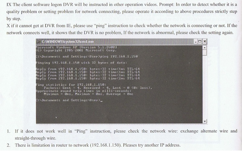

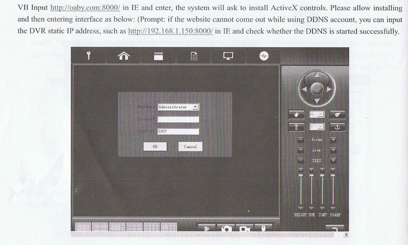

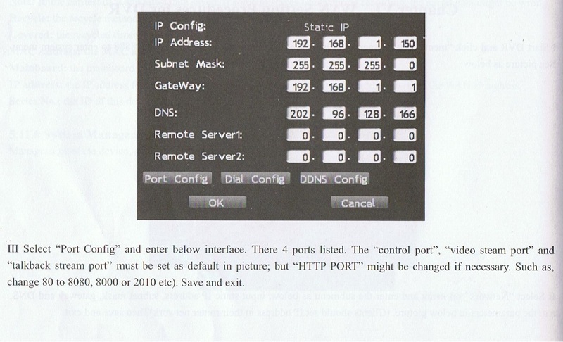

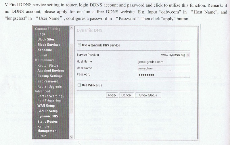

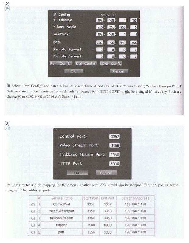

As you can see on picture 2, the Ip settings etc... And on picture 3 the port settings. Do I Input the exact settings in my router settings?? And if so where?? I know how to input port settings but I don't know what location in the router settings I would input the IP, DNS etc.... I have a BT fusion Hub ( business and home built in )
Thanks for your help and I hope the pictures I've posted don't bug you too much....
No, most likely those settings will not work, its possible they will but probably wont.
Go to a computer go to start > run and type cmd then once the command prompt is open type in ipconfig /all
This will give you your computers IP address, DNS servers, Gateway, and subnet you will most likely not need to worry about the 255.255.255.0 is fine.
Once you have that information, you will copy your DNS and Gateway to the DVR as you see it on your computer, now for the IP address you need to pick an IP which almost matches your computer, if your computer is 192.168.1.101 then use something like 192.168.1.150 for your DVR.
I can speak for your router, try clicking through the different tabs until you see the one that covers IP configuration.

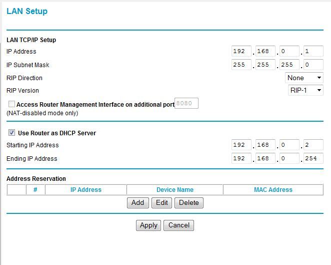

Is this the kind of settings I need to go into?? - LAN setup:
So in the starting IP I would put: my IPv4 address: 192.1.68.0.3
And in the ending IP I could put: 192.168.1.150

You need to use a dynamic DNS (also known as DDNS) account so that the rest of the world knows the path to your DVR.
The IP addresses you are looking at (all of the 192.168.*.* stuff) are private IP's issued by your router and they are internal to the network... period.
Go here to determine what your public IP address is: http://www.whatsmyip.org/
You then need to set up a DDNS account. Go to http://www.dyndns.org and get an account. Let's say you picked an address like this: "myfirstdvr.dyndns.org"
You would then tie that address to your public IP address and add the port you chose in the DVR (we will use 3526 in this example), so it would look like this: myfirstdvr.dyndns.org:3526
The good news is that your DVR has a DDNS client built in, so it will take care of updating the public IP for you if it ever changes. You simply need to get the account, and then plug in those details (username password, domain name) to the DDNS client on your DVR. Also MAKE SURE you get rid of the default password since you posted it on the internet!

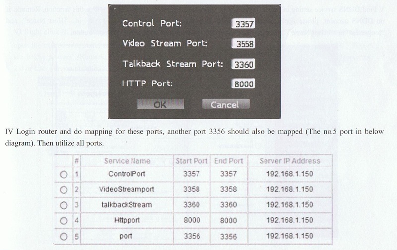

What about these ports: On the manual it tell me to input these ports exactly in the picture:

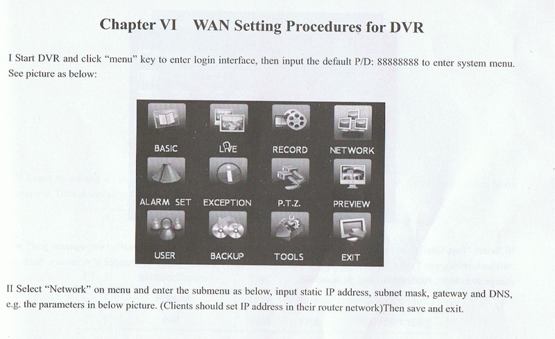

hi. under network on your dvr. the ip should already be there if your dvr is connected to your router.
if not you can add your self an ip.
on dvr>>>>> use these.
ip 192.168.1.260
subnet 255.255.255.0
gateway 192.168.1.254
and you dont need anything in the DDNS fields just leave blank.

The two parts I highlighted are a mismatch, pick one or the other and that should fix it. I would personally not use either of those because they are so common, but make them match and you should be good to go. Feel free to PM me a link if you want it tested from outside your network.
