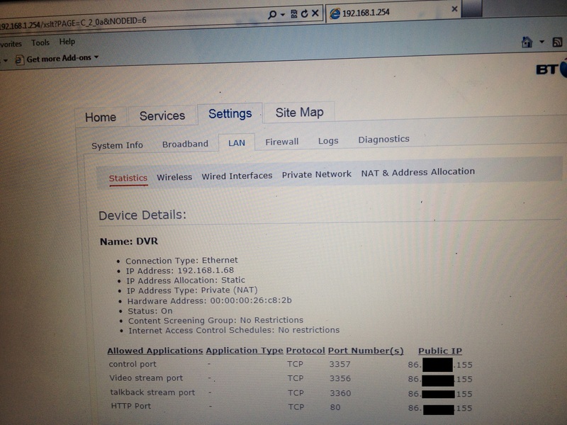

your on a BT 2 wire router. why not just setup via services and not nat. your dvr is the avtech like i said posts back. iphone is eagleye.
all ports are good but as you can see they are directed via external ip.
delete all your settings. then go into services then click add. and make a new rule for each i.e cctv1 port directed to dvr and do that for each port. click apply all done
Hi thanks. So you are telling me that the ports should be directed to my DVR IP address and not my (external) public IP address? On the firewall settings I clicked “Allow pinholes and DMZ mode” “add a new user defined application” then I chose my DVR IP address 192.168.1.68 , I repeated the steps till I finished added the ports. But for some odd reason my (external) public IP address shows up next to the port settings instead, as you can see from the picture above...

I have set up DVR to DHCP which makes my router automatically pick up my DVR IP adderss etc
The ports that are currently forwarded in BT Hume Hub Fort Forward settings are:
Info Port: 3357
Video: 3358
Task: 3360
Web: 80
The above ports are also the only port options input-able within the DVR
