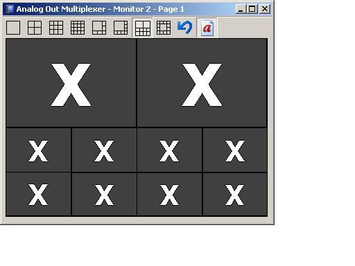

Also, if you want all 10 cameras to display, you'll need to find a DVR that will output a suitable split-screen: equal-size "boxes" will only work in four (2x2), nine (3x3) or 16 (4x4) layouts. The only way to fit 10 with no empty boxes is this:
Amen to that. That's a big one for me and it's why of all the views, be it the local monitor, web access, or MCS, I prefer MCS the best. It has the most flexibility for window positioning. I like full screen and I hate emtpy windows- hate them. I would think the window setup that the dvr outputs is tough to know before hand, unless they give you that info in the manual. We have an openeye dvr 16 channel at work that has 7 channels full at the moment, and it only offers one configuration that works for that with no empty windows- probably one preset that will do a weird config for you. But it sucks and personally I would switch cables around until I got what I wanted to see correctly.
