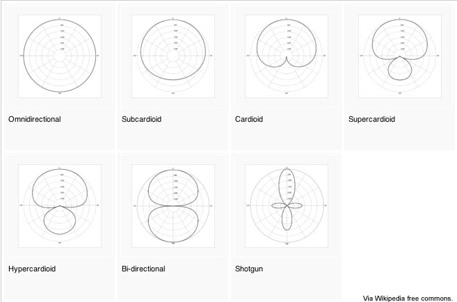

Soundy 1 Posted February 4, 2012 Oh... and most mic selections will be either omnidirectional, or cardioid (aka unidirectional)... go with the latter, so it doesn't pick up excessive noise from the back (it will have a little more sensitivity toward the front). These aren't SUPER directional, they'll still pick up more than a 180-degree arc in front, but it will be a bit more effective than an omni. Share this post Link to post Share on other sites

Fiona 0 Posted February 4, 2012 Thanks for the chart and the advice Soundy. Looking at Louroe now: http://www.louroe.com/ http://www.security-technologynews.com/article/louroe-microphones.html I will add the details of a specific microphone... Louroe seem to have a lot of surveillance microphones. (Mostly I USPS everything straight in from the US. Six days delivery.) Share this post Link to post Share on other sites

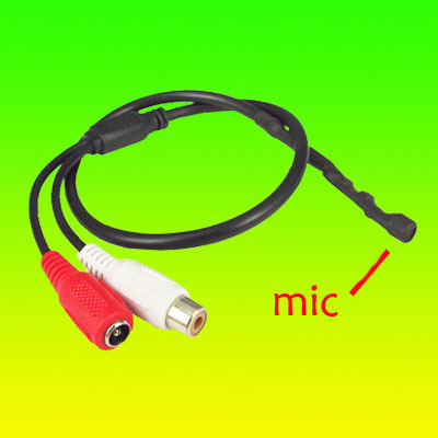

shockwave199 0 Posted February 4, 2012 No matter what the cost? This is under ten bucks. Put it on a cheap cctv cable of any length you need, put a power adapter on it to power it, such as any of the ones you might have laying around from a cctv cam, hook it up to a channel in the dvr, and there you go. Cheap of course, but plug and play compatable I'm telling you, it'll work for you no problem. I tried putting a typical audio condensor mic with battery powered phantom power in a channel with the rca adapter- no go. It just needs a simple cctv dvr mic setup for compatability. Good luck. Share this post Link to post Share on other sites
rory 0 Posted February 4, 2012 shockwave199 said: No matter what the cost? This is under ten bucks. Put it on a cheap cctv cable of any length you need, put a power adapter on it to power it, such as any of the ones you might have laying around from a cctv cam, hook it up to a channel in the dvr, and there you go. Cheap of course, but plug and play compatable I'm telling you, it'll work for you no problem. I tried putting a typical audio condensor mic with battery powered phantom power in a channel with the rca adapter- no go. It just needs a simple cctv dvr mic setup for compatability. Good luck. Yeah but not weatherproof Although you could follow the design of the Louroe Verifact-E and use a weatherproof gangbox, with a hole underneath and seal it a little, maybe with some kind of foam filter (like for a computer fan) or maybe a piece of thick screen (I think the V-E have a metal vent), never used their outdoor ones, but nice thing about their other models are they are plug and play and fit into the environment you need it for - eg. Verifact-A looks like a heat detector, install them on drop tiles in stores, etc ... and they are perfect - most will never think they are mics. Ive run them 100' with 2 pair telco wire before. And an example, in a cash box at a gas station you can hear everything out at the pumps, in the cash box, and in the store. Share this post Link to post Share on other sites
shockwave199 0 Posted February 4, 2012 Yes, the ones I mention are cheapy for sure and not for outdoor. The louroe looks great. Share this post Link to post Share on other sites
rory 0 Posted February 4, 2012 shockwave199 said: Yes, the ones I mention are cheapy for sure and not for outdoor. The louroe looks great. though one could weatherproof the cheap one .. if they cant afford the louroe Share this post Link to post Share on other sites
