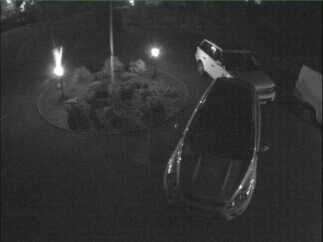

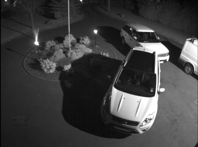

chesterfield 0 Posted February 29, 2012 Avigilon 5mp dome, 300W floodlight, garden lights are 17w, distance from camera to top of image aprox 125ft. Sorry, don't know lumens from each light, will check. I intend to get some IR floodlight illumination as houses across the street may not appreciate floodlights on all the time. The problem I am having at present, prior to having adequate night time illumination is that setting the motion sensor to pick up movement at night, results in it being overly sensetive during the day - slight light changes on the big white bonnet/roof of the vehicles causes LOTS of false motion detections during the daylight hours. Turn the sensetivity down to clear those during the day, and it will pick up virtually nothing short of a whole vehicle moving at night. At present Im letting it chew disk space during the day on false hits and ensuring motion at night gets captured. Hopefully once the area is lit well at night, I can turn the sensetivity down to tune out the fale hits during the day. Or I could just go PIR detection, but really cant be bothered - would rather just throw extra disk space at it to be honest. Anyway.... Floodlight & garden lights: Garden lights only: Share this post Link to post Share on other sites

mike_va 0 Posted February 29, 2012 Avigilon 5mp dome, 300W floodlight, garden lights are 17w, distance from camera to top of image aprox 125ft. Sorry, don't know lumens from each light, will check. Nice pic, noticed the shutter speed could go down to 2 sec. Do you happen to know how you have that set up for shutter speed? Share this post Link to post Share on other sites
thewireguys 3 Posted February 29, 2012 Avigilon 5mp dome, 300W floodlight, garden lights are 17w, distance from camera to top of image aprox 125ft. Sorry, don't know lumens from each light, will check. Nice pic, noticed the shutter speed could go down to 2 sec. Do you happen to know how you have that set up for shutter speed? Default setting is 1/30 for the JPEG2000 with a max of 2sec. H.264 has a default of 1/30 and max 1/30 Share this post Link to post Share on other sites
chesterfield 0 Posted March 1, 2012 Will try and get the full res pics up tonight when I am back at home and have access to the client/server. Only have web access at present as I still havent bought the gateway add on just yet. I shall also post the settings of the camera. I believe from memory this is set at 1/50. 1/30 at night left just a little too much motion blur for my liking, especially with just the garden lighting. I am hoping that with ample IR floodlighting that I may be able to even bring this down to 1/100, but that may be ambitious. I still need to adjust the focus slightly as the focus is a little too near. Id prefer focus on about midway down the shot. The intention is to have futher cameras covering areas closer to the house, and leaving this camera covering a main area of the front. Other cameras are a 2mp internal H264 dome, and 2 x 2mp External H264 dome. (Avigilon again) I am enjoying the learning exercise with this install (which is my first play with any cctv equipment). Learning about lighting and how it affects the cameras in different locations is interesting. I know that the install would have been finished a lot quicker using a professional installer, and I would not have these issues with lighting and learning how and where to position things, but Im enjoying it so dont mind the extra time its taking me. An issue I found out I have with one of the cameras is that it looks across an area which has a wall with the central heating boiler vent sited on it. Every day, twice a day I get about half an hour of steam being recorded at a lovely 30fps. I have tried to remove this area from the motion detection best I can, but removing the whole area where steam could be detected will also remove a doorway from being monitored. So I'm looking into extending the flue for the vent to move it out of shot Share this post Link to post Share on other sites
