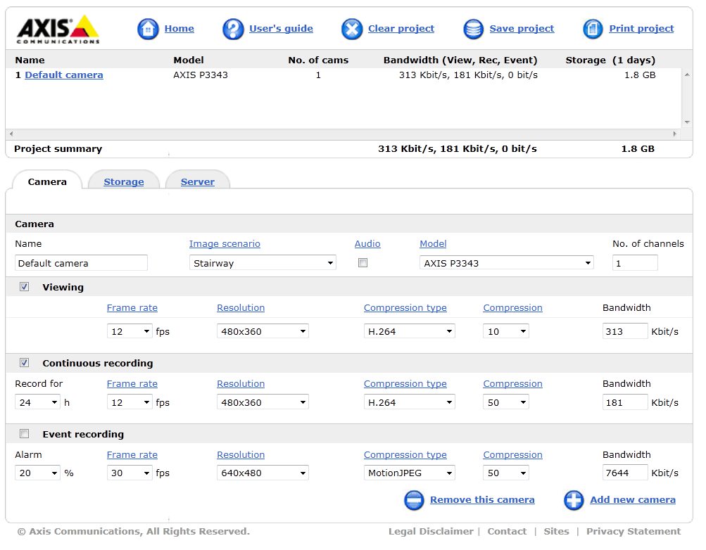

I am only concerned with working out the daily recording rate. They have told me to use the Axis design tool 1 even though its discontinued and when I input the parameters I get a daily recording rate of 3.2GB per day per camera that is if you use the data shown above,
Design Tool 1

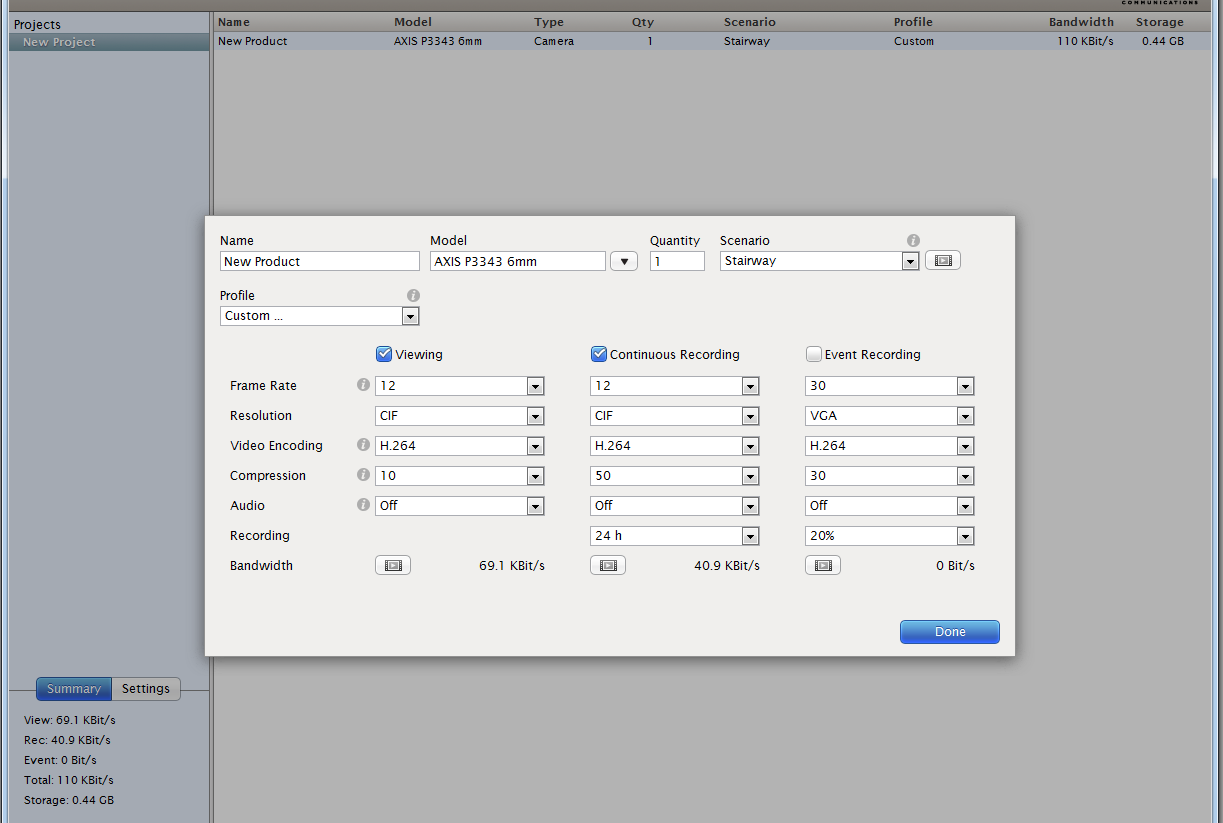

If however I use design Tool V2 which Axis recommend I get vastly different storage results-
http://www.axis.com/products/video/design_tool/v2/http://www.axis.com/products/video/design_tool/v2/
With the same parameters although you are choosing CIF instead of 480x360 I get a figure of 5.23GB per day.

I have obtained the following results:

Axis Design Tool 1 (320*240) - 80kBit/s 843.7MB/day
Axis Design Tool 1 (480*360) - 181kBit/s 1.8 GB/day
Axis Design Tool 2 - (CIF=352*288) - 40.9kBit/s 0.44 GB/day
The Axis Design tool 2 gives result in 2.5 times less than the Axis Design Tool 1.
It seems like an error in the Axis Design Tool 2:
In the Axis Design Tool 2, 4CIF produces in 10 times more traffic (427 KBit/s) than CIF (40.9KBit/s), but the 4CIF has only in 4 times more pixels.
In the Axis Design Tool 1, 640*480 produces in 4 times more traffic (321 KBit/s) than 320*240 (80KBit/s), that is correct.

Axis Design Tool 1 (640*480) - 1268kBit/s 13 GB/day
Axis Design Tool 1 (800*500) - 1650kBit/s 16.9 GB/day
Axis Design Tool 2 - (4CIF=704*576) - 1.71MBit/s 18.5 GB/day

I get 1.4GB per day on Design Tool 1.
If I use design tool 2 and I have no option to select 480*360 and so I use this profile
CIF

I get 5.23GB per day on Design Tool 2.
Is it me or is there a bug on the Version 2 design tool as its nearly 4 times more storage on version 2.
I get 1.8GB (Compression=50). May be you just used other compression ratio.

I understand that the Axis Design Tool 2 doesn't allow to specify pixels directly.
But the CIF is 384*288=110592 pixels is not equals to 480*360=172800 pixels. The 480*360 image has in 1.56 times more pixels therefore it must have in 1.56 more file size (in bytes).

I get 0.44GB (Compression=50). May be you used other compression ratio and mistaken with number of days.
This is the same as 0.44*1.56=0.69GB for 480*360. It is in 2.5 times less than in Axis Design Tool 1 (1.8GB). It seems like an error in Axis Design Tool 2.
