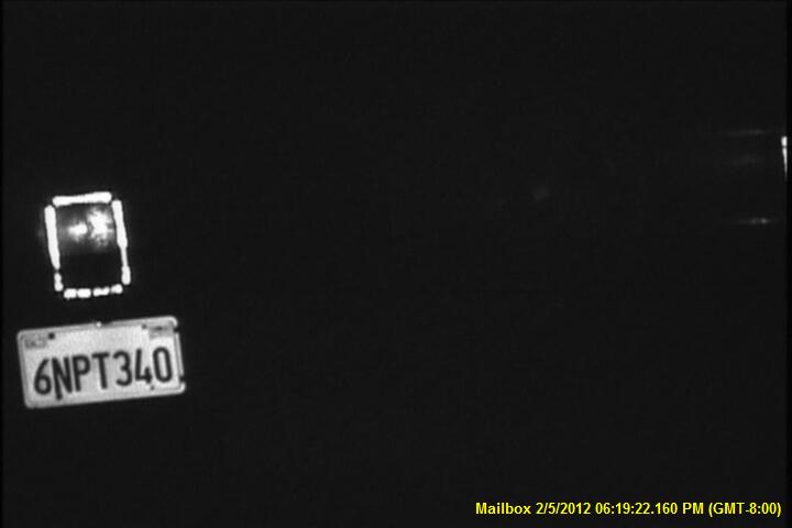

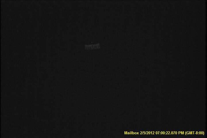

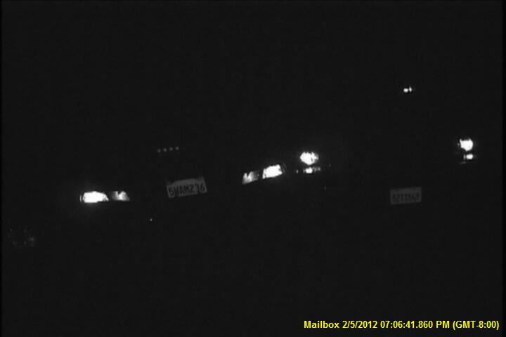

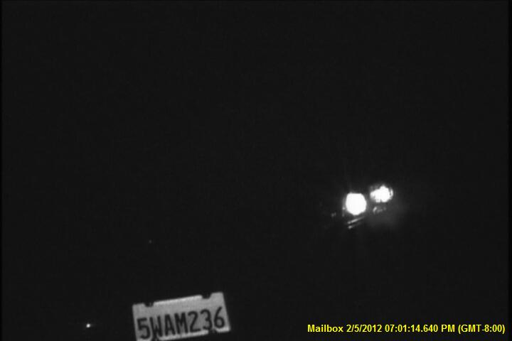

cglaeser 0 Posted February 16, 2012 Messoa SCR510 Day 100 feet Messoa SCR510 Day 145 feet Messoa SCR510 Night 50 feet (tail light with lighted plate) Messoa SCR510 Night 70 feet (headlight with non-lighted plate) Messoa SCR510 Night 130 feet (headlight with non-lighted plate and tail light with lighted plate) Messoa SCR510 Night 145 feet (no lights, and beyond the specification of the IR) Share this post Link to post Share on other sites
mike_va 0 Posted February 16, 2012 Looks like it does a good job, within the limits of its range. Of course one might hope so given the price...thanks for posting the pics Share this post Link to post Share on other sites
