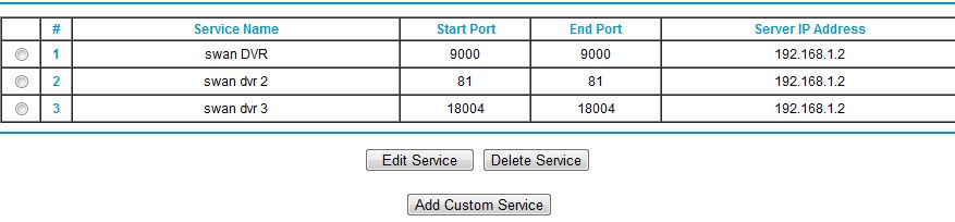

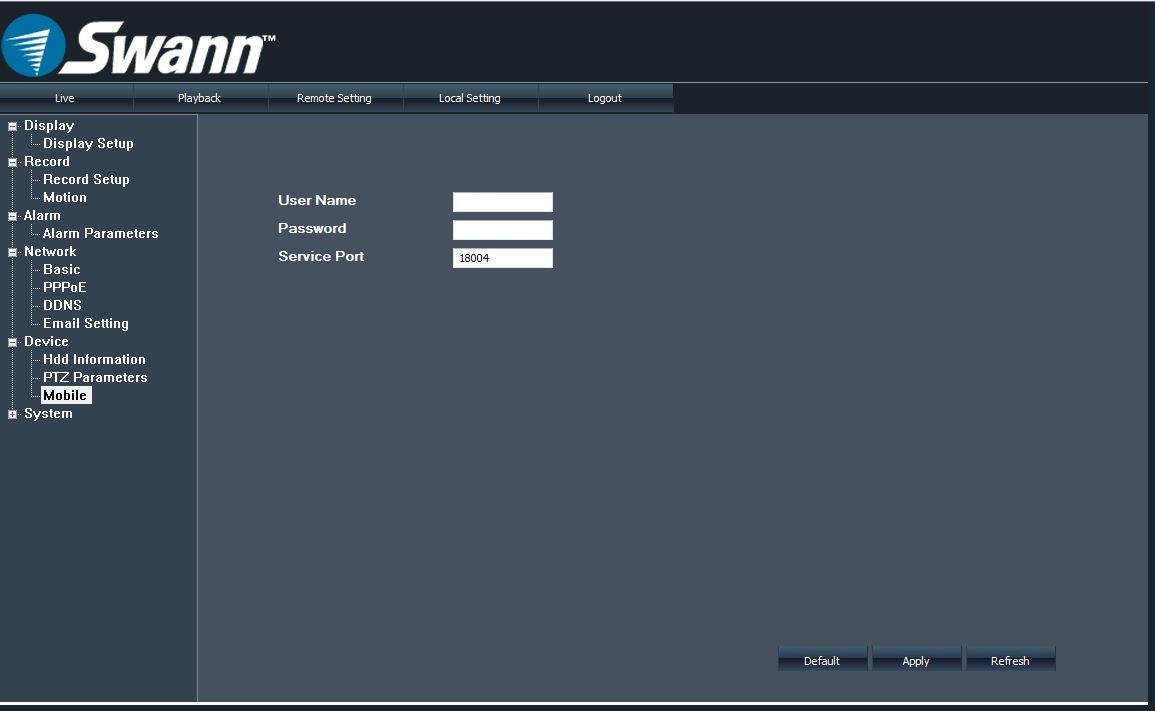

tomdlgns 0 Posted February 11, 2012 a friend has a swann DVR in his shop and he had a company run cameras, wire, configure the DVR (swann DVR), etc...but when it comes to networking/static ip's, port forwarding, etc...he didnt have any networking equipment installed at the time, in his shop. i work full time and i work with systems that were well out of his price range, which is why i didn't do the install/buy the equipment. of course every piece of documentation is sitting in a dumpster. i have already statically assigned the DVR the following IP: 192.168.1.2 and opened the following ports in his router: 9000, 81, 18004 and forwarded them to 192.168.1.2 i can access the DVR from the web browser by going to http://hisDDNShostname:81 (client running on his PC updates the IP when it changes) i login with the user name/password i setup in the DVR and everything works great i downloaded the swann DVR app on his iphone and logged in and see camera views, but this is where the problems occur. it asks me for port # and max channel i assumed the port was 9000 because that is what it showed me on the browser when i logged in and i dont know what max channel is. is it asking me how many channels i want accessible on the iphone? he has the 8 channel dvr with 7 cams. when it works, it seems to only work some of the time. i know that his no-ip account is working properly because i am able to test it from my web browser in a different location. if no-ip wasn't working, i wouldn't have been able to see his cameras off site. i am wondering if i have all of the ports open for the mobile device/app (swann dvr for the iphone), maybe i missed something? has anyone setup a swann dvr for web/iphone access? here is a pic of the router settings i am logged in, off site right now, and these are the settings i see on his DVR service port: media port and web port: Share this post Link to post Share on other sites
tomcctv 190 Posted February 11, 2012 Hi. the port number is 18004. and you also need to add a user name and password to this page. Share this post Link to post Share on other sites
tomdlgns 0 Posted February 11, 2012 tomcctv said: Hi. the port number is 18004. and you also need to add a user name and password to this page. i do have a user name/pass, i removed it for the screen shot. it was somewhat personal info. Share this post Link to post Share on other sites

tomcctv 190 Posted February 11, 2012 tomdlgns said: what? i have a swann dvr w/o documentation. in the first post i took screen shots of all the settings i configured based off of what i was able to find in the system. since i dont normally work with swann dvr, i am trying to see if someone has worked with them, more than i have, and can guide me in the right direction. thanks. i take it you missed my first post. i phone you have to use port 18004. and the manual also tells you. so my first post you need port 18004 did it work ??? Share this post Link to post Share on other sites
tomdlgns 0 Posted February 11, 2012 tomcctv said: tomdlgns said: what? i have a swann dvr w/o documentation. in the first post i took screen shots of all the settings i configured based off of what i was able to find in the system. since i dont normally work with swann dvr, i am trying to see if someone has worked with them, more than i have, and can guide me in the right direction. thanks. i take it you missed my first post. i phone you have to use port 18004. and the manual also tells you. so my first post you need port 18004 did it work ??? nope, not working. the iphone is asking for: 1 device name 2 address 3 port 4 user id 5 pass 6 max channel what i have tried: 1 business name 2 ddns host name 3 18004 4 hisname 5 his pass 6 8 sine i am using port 81 instead of 80, which is open, i tried ddns hostname:81 and that didnt work, either. its funny, every other system i have worked with that has proper documentation is a breeze to setup. Share this post Link to post Share on other sites
tomcctv 190 Posted February 11, 2012 tomdlgns said: the iphone is asking for: 1 device name 2 address 3 port 4 user id 5 pass 6 max channel yes thats right. all this needs to be set on the app before you can connect. tomdlgns said: sine i am using port 81 instead of 80, which is open, i tried ddns hostname:81 and that didnt work, either. port 80 or 81 is no good for iphone. 18004. ill find a old spec for you Share this post Link to post Share on other sites
tomcctv 190 Posted February 11, 2012 http://www.swann.com/images/phones/SwannView_Manual_for_iPhone_v1.5.pdf Share this post Link to post Share on other sites
tomdlgns 0 Posted February 11, 2012 tomcctv said: tomdlgns said: the iphone is asking for: 1 device name 2 address 3 port 4 user id 5 pass 6 max channel yes thats right. all this needs to be set on the app before you can connect. tomdlgns said: sine i am using port 81 instead of 80, which is open, i tried ddns hostname:81 and that didnt work, either. port 80 or 81 is no good for iphone. 18004. ill find a old spec for you the iphone is asking for: 1 device name 2 address 3 port 4 user id 5 pass 6 max channel what i have tried: 1 business name 2 ddns host name 3 18004 4 hisname 5 his pass 6 8 i am using 18004 read above yes, i have set this info in the DVR. Share this post Link to post Share on other sites
tomdlgns 0 Posted February 11, 2012 thank you for posting that PDF. unfortunately, i had it configured the same as the PDF and i am still having the same issue. i can only get one cam to pop up on the app. i can cycle through all the cameras, but only in 1 window in the app. i have tried adding a camera to spots 1,2,3, but they only pop up in spot 4. not sure what else to try if the port information is accurate. thanks. Share this post Link to post Share on other sites
