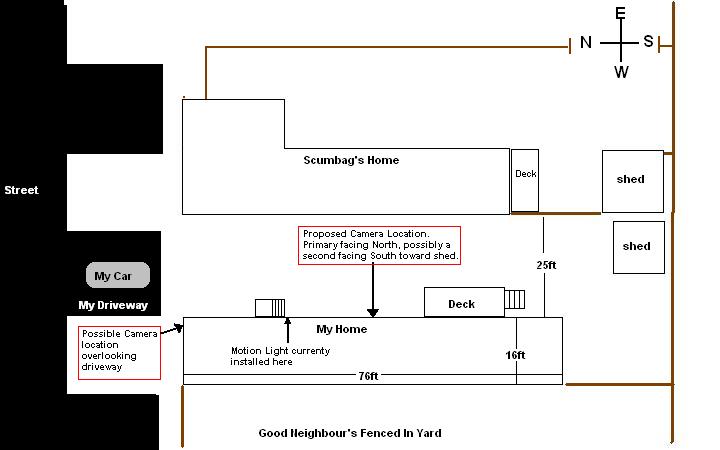

Supernaut 0 Posted February 14, 2012 (edited) New user here could use some help with a setup. I'll try not to make this too long I live in a mobile home park in Alberta, Canada. I have had a long time problem with my next door neighbor, too long to write it all here. Lets just say he's an arrogant ass probably 45 years old with all the maturity of 8. His wife isn't a whole lot better. The longest standing problem with these people have been their dogs crapping on my lawn. In the summer sometimes on a nearly daily basis going on for 2 years. I've tried damn near everything in my legal means. In the most recent incident I threw the dog crap on their deck which led him to call the police. He made up a story how I broke into his place twice and threatened him which the police didn't buy at all. The situation didn't go his way in the slightest which lead him to throw a tamper tantrum and threatened a formal complaint against the police. Lets just say the police were happy after that to work with me to charge him with whatever we can. They also said they're sorry I have to live next to this and feel bad for me. Its just one of several stories in this paradise. It seems the police are out here every month or so and every time that ass clown is involved. They've been to his house twice in the past week for what best I can tell is a spousal abuse situation. Hopefully he just ends up in jail soon and I don't have to deal with him We own our homes here but a landlord owns the land. I have struck a deal with the land lord that the neighbor from hell has to get rid of all his 3 dogs if I can provide photo proof of them in my yard. This has been difficult because I'm often not home. I drew a starving artist windows paint picture of my yard. It is relatively to scale by eyeball. Brown lines represent fences. The property line ends 1ft west (on this side of the street) of our homes. The primary camera needs to be in the center where the arrow points. My living room is in the middle of my home, also my TV/entertainment stand is there. Also there is a hole in the wall there where a satellite tv cable goes through, this is where I would put any camera wiring. I would connect the DVR to my plasma TV located on that wall. One camera on the front of my place would be nice as well but wiring would be much more complicated. I plan to live here until My lady and I can save a 20% down payment for a house which should be less than 2 years. Believe me I would be gone away from this human garbage ASAP if money were not the issue. In the interest of selling this place I want to molest the walls as little as possible with holes for wires...etc. Another consideration is temperature. In the winter up here we usually have a few weeks were the temperature is -30C (-22F) or worse, sometimes going even lower than -40C (-40F) but that usually only happens a day or 2 per year. The camera(s) would have to be able to function in severe cold. The cameras need to be able to provide night vision. Just decent enough that the police would find it acceptable. I don't need to guide a missle through a door way 3km away here. Cost. I hope to do this for under $1000. I think $1500 would be my absolute limit. Its bad enough I have to waste any money due to the trash I live beside. I am very new to this but not 100% green. I had a Lorex camera system a few months ago but returned it. I bought Lorex after reading reviews which seemed to indicate a good value for the money. I was broken hearted to learn that infrared cameras can't look out through windows and I couldn't install those cameras outside due to the temperatures here. It was 4 cameras with a 250gb dvr system for $400. The camera video quality system seemed decent and night vision good enough for my purpose when I tried them outside. My intent was to run at a relatively slow frame rate for little hd space usage. I have a motion light out there that helped a lot as well. I understand heated cameras would be more costly. So would any knowledgeable members have any particular advice for cameras, camera systems, my best course of action, or anything at all? Also this isn't just to capture dogs on video. I just plain don't trust them. If I went on vacation I wouldn't put it past him to vandalize my place. And who knows what else. Lots of good people living amongst 65 mobiles in this park and I get stuck next to these people. I must have been one of Genghis Khan's henchmen in a former life to deserve this. Edited February 14, 2012 by Guest Share this post Link to post Share on other sites
Fiona 0 Posted February 14, 2012 In this circumstance, the use of IRs would allow you to video any events without showing your hand. "to learn that infrared cameras can't look out through windows and I couldn't install those cameras outside due to the temperatures here" IR works through windows. External IR units can function at temperatures as low as -58 degrees Fahrenheit. By removing the visible lights operated by motion detectors, you could encourage more events. The use of covert cameras would work to your advantage. Any sign of a camera or technology is likely to put that belligerent neighbour on guard. When you have the system that the old hands will recommend, install it quietly, then look defeated. Drop your guard. Appear to give up. The neighbour will walk right into the trap. Share this post Link to post Share on other sites

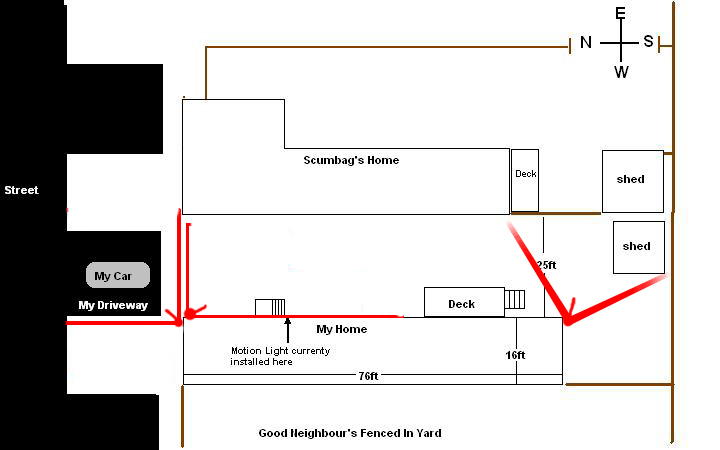

Fiona 0 Posted February 15, 2012 Supernaut said: In the interest of selling this place I want to molest the walls as little as possible with holes for wires...etc. Another consideration is temperature. In the winter up here we usually have a few weeks were the temperature is -30C (-22F) or worse, sometimes going even lower than -40C (-40F) but that usually only happens a day or 2 per year. The camera(s) would have to be able to function in severe cold. The cameras need to be able to provide night vision. Just decent enough that the police would find it acceptable. I don't need to guide a missle through a door way 3km away here. Cost. I hope to do this for under $1000. I think $1500 would be my absolute limit. Its bad enough I have to waste any money due to the trash I live beside. I have a motion light out there that helped a lot as well. I understand heated cameras would be more costly. So would any knowledgeable members have any particular advice for cameras, camera systems, my best course of action, or anything at all? Also this isn't just to capture dogs on video. I just plain don't trust them. If I went on vacation I wouldn't put it past him to vandalize my place. And who knows what else. 1. To get up and running ASAP, might be an idea to run the cabling through a cabinet floor and onto the deck. 2. Any 4 or 8 channel Dahau DVR will be fine. 3. IR bullets would be adequate. Anyone have any suggestions for sub-zero bullets? 4. You won't need to spend much on this system. (Notwithstanding the temp issue.) Share this post Link to post Share on other sites
Soundy 1 Posted February 15, 2012 You could put a four-channel Dahua and four VCM-24VFH (H for Heater) domes in and keep it well under $1500. The cameras work great in low light (see samples here), they're solid and vandal-resistant, and the 2.8-10.5mm lens will give you lots of flexibility in getting the FOV you need. Share this post Link to post Share on other sites

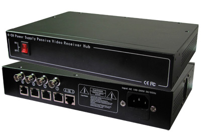

Soundy 1 Posted February 22, 2012 Fiona said: What about a Power Supply? If you're using Cat5 and baluns, go with one of these: http://www.easterncctv.com/accessories/ev04p-vps.htm We've used the 16-channel versions on our last two big installs (two per site) and they've been working great. Baluns and power supply all in one unit - combine with baluns like this: http://www.easterncctv.com/accessories/ev01p-vp-t.htm and it makes UTP installation about as plug'n'play as it gets. Only other thing you need then is a set of short BNC patch cables from the VPS unit to the DVR. Share this post Link to post Share on other sites
jxk716 0 Posted February 22, 2012 Soundy said: If you're using Cat5 and baluns, go with one of these: http://www.easterncctv.com/accessories/ev04p-vps.htm We've used the 16-channel versions on our last two big installs (two per site) and they've been working great. Baluns and power supply all in one unit - combine with baluns like this: http://www.easterncctv.com/accessories/ev01p-vp-t.htm and it makes UTP installation about as plug'n'play as it gets. Only other thing you need then is a set of short BNC patch cables from the VPS unit to the DVR. Soundy said: (I could get you into a $3000 PC-based DVR with all the bells and whistles ) Soundy, 2 questions: 1. What is the quickest way to terminate the Cat5 at both ends? I'd like to try this configuration some day but concerned that making the RJ-45s will take too much time. Then again I am no expert with this stuff. Also, I may get funding to replace our 16 channel PC based DVR. Can you recommend some? I am not sure what the budget is yet but sometimes they give me a bunch to spend. Share this post Link to post Share on other sites

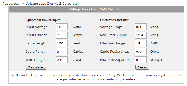

rory 0 Posted February 22, 2012 Soundy said: If you're using Cat5 and baluns, go with one of these: http://www.easterncctv.com/accessories/ev04p-vps.htm Do you know how much current they supply and to what distance? Eg. if using 12VDC 550ma cameras. Share this post Link to post Share on other sites
Soundy 1 Posted February 23, 2012 jxk716 said: Soundy, 2 questions: 1. What is the quickest way to terminate the Cat5 at both ends? I'd like to try this configuration some day but concerned that making the RJ-45s will take too much time. Then again I am no expert with this stuff. First time we used these, we terminated everything in a patch panel... but there were several IP cameras that needed to be connected to a switch, and we had a separate rack all to ourselves fro the VPSs, patch panel and switch... latest job, we had to share a rack and had no extra space for a patch panel and only one IP camera, so we just terminated all our runs with RJ-45 plugs. It doesn't take long once you get the hang of it... one of our members here made a YouTube video for it, although I can't recall who. Been meaning to do one myself. If you have the room, definitely terminate to a patch panel - makes it much easier if you need to switch any cameras to IP later, as you just move your patch cable from the VPS to the switch. Quote Also, I may get funding to replace our 16 channel PC based DVR. Can you recommend some? I am not sure what the budget is yet but sometimes they give me a bunch to spend. www.3xlogic.com - really nice systems: all systems are hybrid, and the NVR is the exact same system just minus the analog capture card. IP and analog cameras all in the same interface. It can also do motion-detection recording and analytics for any cameras, in the server - IP cameras don't have to have their own motion detection, like you see with some other NVRs (you CAN use theirs as well, but it's not required - always nice to have options). Share this post Link to post Share on other sites
Soundy 1 Posted February 23, 2012 rory said: Soundy said: If you're using Cat5 and baluns, go with one of these: http://www.easterncctv.com/accessories/ev04p-vps.htm Do you know how much current they supply and to what distance? Eg. if using 12VDC 550ma cameras. Should be no different than any other 12VDC power source - it's 12V regulated output, so distance all depends on the cameras and how much loss they can handle. The jacks use three pairs for power by default, so you get the max range possible - specs page says up to 750'. The first site we used them, they added another camera to an area we didn't have a wire, so we split off a pair from the next closest camera... probably close to 150' to the first camera and another 50' to the second, both running over only two pairs. Both CNB VCM-24VFs, rated about 250mA at 12VDC, so that would be a total of around 500mA, and they're running no problem (then again, those cameras will also work all the way down to 10V or so). Share this post Link to post Share on other sites
rory 0 Posted February 23, 2012 Soundy said: rory said: Soundy said: If you're using Cat5 and baluns, go with one of these: http://www.easterncctv.com/accessories/ev04p-vps.htm Do you know how much current they supply and to what distance? Eg. if using 12VDC 550ma cameras. Should be no different than any other 12VDC power source - it's 12V regulated output, so distance all depends on the cameras and how much loss they can handle. The jacks use three pairs for power by default, so you get the max range possible - specs page says up to 750'. The first site we used them, they added another camera to an area we didn't have a wire, so we split off a pair from the next closest camera... probably close to 150' to the first camera and another 50' to the second, both running over only two pairs. Both CNB VCM-24VFs, rated about 250mA at 12VDC, so that would be a total of around 500mA, and they're running no problem (then again, those cameras will also work all the way down to 10V or so). What I meant is how well can it send 550ma 12VDC over that cat5 at a distance? lets say the distances range from 65 feet to 150 feet. Say I have 3x 550ma cameras, and 1x350ma camera (all IR) I need to run new cables on a job - choice is a cat5 4 way balun and try power them all with that cat5, or run all RG59 - if im to run 18awg i may as well run RG59 one time, less connections and superior cable for security in this case (stronger for non conduit run, client will not pay for conduit so its run loose and tie strapped in open warehouse). Lets forget the strength of the cable for a minute, but can that cat5 24 awg hold enough power for those cameras at that current draw - if that is the real current draw - may be more as these are OEM cameras. How does this device get past the normal limitation of that kind of thing - I seriously want to know if it will save me work and money in the future. I dont want to hear about use non IR cameras because that is NOT an option. Thanks bro Share this post Link to post Share on other sites
Soundy 1 Posted February 23, 2012 rory said: What I meant is how well can it send 550ma 12VDC over that cat5 at a distance? As well as any other 12V power supply. Ohm's Law applies just the same. The only potential concern might be the total current supply capability of the unit, and unfortunately there's no mention of that in the specs... rory said: How does this device get past the normal limitation of that kind of thing Nobody ever claimed it did. It's 12VDC regulated output to the camera... same calculations, same limitations apply whether you're using this or an Altronix can or a wall-wart. According to http://www.netkrom.com/voltage_loss_over_cat5_calculator.php - 12V, .55A, 150', three pairs of 24AWG, you should only see 0.4V loss at the load. (and according to this, three pairs of 24AWG is the same effective gauge as 18AWG). One thing I HAVE discovered with these units, they have built-in, auto-resetting protection on every channel... I had a CW504 dome that would fire up and then go out after 30 seconds or so, and the status light on that channel of the VPS would go from green to yellow... unplugging that cable, the light would go back to green, and the cycle would repeat after plugging it back in. We traced it to a damaged cable that was putting a short on the power... the unit detected the overload and shut down that output, then reset it once the short was removed. Share this post Link to post Share on other sites
