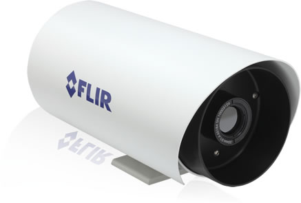

Soundy 1 Posted February 18, 2012 I wish I could find my pictures of this site... we have a FLIR wide-eye camera and two FLIR SR-19s (all thermal imaging) feeding an ObjectVideo analytics system, triggering a Pelco Esprit PTZ, all on top of a 50'-ish tower. Nice setup. Share this post Link to post Share on other sites
