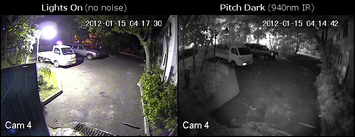

rory 0 Posted February 21, 2012 KT&C KPC-N501NU-B TDN IR Bullet, Sony Effio 700TVL, 2.8-12mm, 940nm IR LEDs. Short range near invisible IR, useful for TDN camera that doesn't need a ton of IR. Share this post Link to post Share on other sites
rory 0 Posted February 21, 2012 Seriously Ive been using IR cameras for over a decade, and I thought this sucker was broken! have to go right up to it to only see a very VERY faint glow. I didnt even think to check the specs for whether it was 830 or 940nm prior to purchase .. In my case I didnt need IR at all, but impressed it worked so well either way. Sure its no Bosch Extreme camera, or Panasonic with Raytek .. But for the price compared to others I have used/tested .. works well. After all a TDN is just doing the job of 2 cameras anyway. If you want the best, get 2 separate cameras Share this post Link to post Share on other sites
excableguy 0 Posted February 21, 2012 Those bullet cams really do look good. Share this post Link to post Share on other sites
videoVIP 0 Posted February 21, 2012 excableguy said: Those bullet cams really do look good. Agreed. What are you recording them with and are those pics from a "live" shot or from "tape"? Share this post Link to post Share on other sites
rory 0 Posted February 22, 2012 videoVIP said: excableguy said: Those bullet cams really do look good. Agreed. What are you recording them with and are those pics from a "live" shot or from "tape"? thats playback, recorded on a Dahua LE-A DVR. Share this post Link to post Share on other sites
videoVIP 0 Posted February 22, 2012 rory said: videoVIP said: excableguy said: Those bullet cams really do look good. Agreed. What are you recording them with and are those pics from a "live" shot or from "tape"? thats playback, recorded on a Dahua LE-A DVR. Is there a "brand name" on the DVR or is it "Dahua"? Share this post Link to post Share on other sites
rory 0 Posted February 22, 2012 videoVIP said: Is there a "brand name" on the DVR or is it "Dahua"? In this case its branded by XTS Video out of Florida. Its the same unit though that others brand under different names. Example, the QVis Apollo HD. I get the QVis cheaper than the XTS so i now use those But the actual model from the manufacturer is the LE-A. We can normally tell what is what by the specs alone. Share this post Link to post Share on other sites
