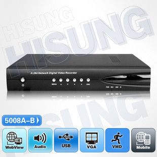

tomcctv 190 Posted February 22, 2012 They have not suggested anything, instructions are vague and generic, I wish I woulda known there was no support, instructions and online, before I purchased. I have used 4 diff apps now, all very common...Ip cam viewer, mviewer, iwatchdvr, and divis dvr viewer. can you take a picture of your dvr and if possable a picture of the dvr screen. OSD Share this post Link to post Share on other sites
tomcctv 190 Posted February 24, 2012 Hi cant find much support for the remote viewing. but you have a HiSung D1 DVR, DVR5008A-B. android link from there site does not help much. you will just have to try some. http://www.androidzoom.com/android_applications/h.264+dvr Share this post Link to post Share on other sites
trikeusa 0 Posted February 24, 2012 thanks for the info, i found some information. its recommended that i use an app called TMEye. i installed that and got connected to my server but cannot see cameras. I guess i will hafta keep trying different things and different apps. maybe i hafta be in record mode on dvr? for the ip adress i entered the ip address i got from canyouseeme.com., which is the isp address. im wondering if i hafta use this ip in my router settings or if my router settings are wrong? Share this post Link to post Share on other sites
