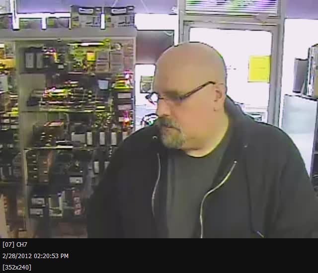

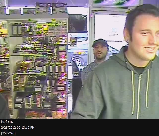

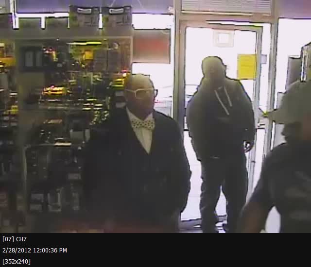

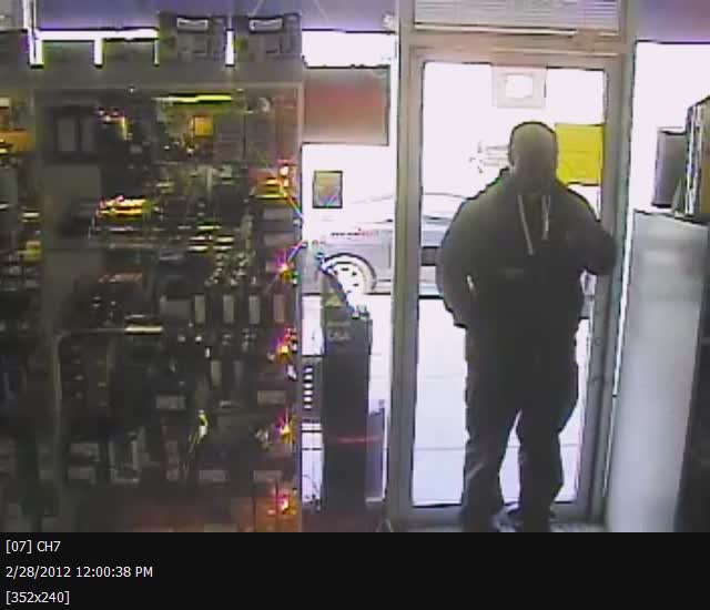

gunworld 0 Posted February 29, 2012 I am using a Vitek VTC-C770WS Pixim Seawolf Powered WDR Color CCD Camera w/700TVL - Short Body (2.40"L) 12/24V, OSD with a Fujinon - YV10x5B-SA2L Varifocal 5 to 50mm f/1.3 DC powered auto iris system Lens. I am having trouble with the back lighting if that’s the correct term. I have a doorway as seen in the picture. The camera is about 15 feet away. In the late morning to about 5:00 pm the face cannot be made out. After 5:00PM it just perfect. Is there anything I can do with the camera setting or do I need to relocate the camera? Am I using the best camera for my situation? I am trying to get the best head shot of each person walking in the front door. Morning Shots After 5:00PM Shots Share this post Link to post Share on other sites
HTElectrical 0 Posted February 29, 2012 You need a camera with BLC. Share this post Link to post Share on other sites
rory 0 Posted February 29, 2012 Best WDR camera would likely be Panasonic. But it comes with a big price tag. Try changing the camera to BLC instead of WDR if it has that option. On cheaper WDR cameras that tends to help when their WDR function fails to work as advertised (most of the cheaper WDRs just fail in that area - eat it up to marketing hype). Share this post Link to post Share on other sites
rory 0 Posted February 29, 2012 Another thing to add, BLC works better than WDR on these cameras when dealing with darker faces - I dont think the Asians test them like we do Share this post Link to post Share on other sites
rory 0 Posted February 29, 2012 Last thing .. make sure WDR is even enabled. On the CNBs they come with all BLC features disabled which means WDR is disabled by default, on their WDR camera Share this post Link to post Share on other sites
rory 0 Posted February 29, 2012 Last Last thing .. since I cannot edit posts on this forum anymore ... Try mounting the camera higher, in my tests the Backlighting/WDR function works much better when mounted higher than actual face height, eg. 8 feet or so. Share this post Link to post Share on other sites
