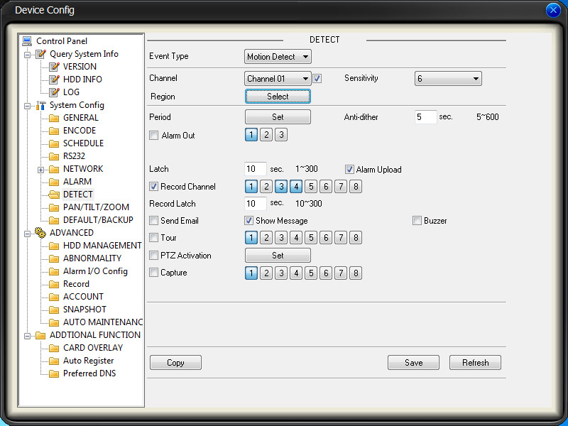

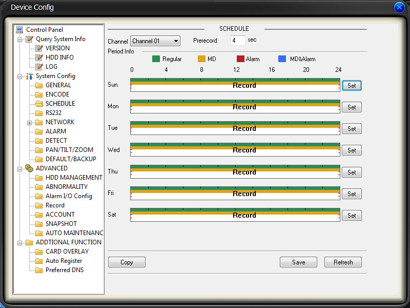

I'm lost here, probably missing something tiny, but I just can't figure this out. I *think* I've set my cameras to record 24/7 and allow me to search for just motion events. Please see screen shots:
For the "region" setting under each channel, i've highlighted the entire FOV with the light blue to make it "active".
Whenever I search for motion recordings, it just tells me "No record". Any help is appreciated!

It indeed looks like you have channel 1 setup properly for MD recording. I am not sure about the other channels though. What happens when you just search for channel 1? What happpens when you search at the console?
Are you computer time and your DVR time mathched up? Just make sure that one is not one hour behind the other, a few minutes off is no big deal.

So I hooked a TV up directly to the DVR and I think I've found the problem. I noticed that the motion indicator was constantly on for all channels. Apparently the sensitivity was too high and the motion was constantly being triggered. I bumped it down to 4 and the motion indicators went off. Maybe this will resolve it, i'll try searching again after capturing some more footage.
