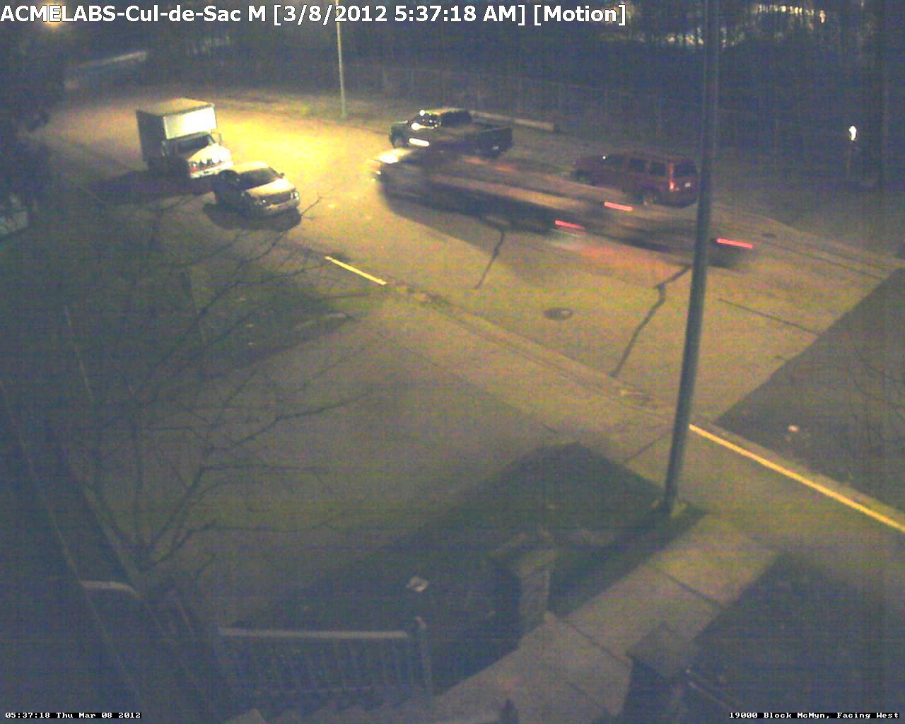

Soundy 1 Posted March 8, 2012 Gads - you need a proprietary remote to access the OSD?? 42 LEDs and that's all you get for illumination? *gak* You shouldn't be asking why a $60 camera is "outperforming" a $200 camera, you should be asking why you paid $200 for a $30 camera. "Sense Up" is a "trick" many cameras use to get better night shots by slowing down the shutter speed, thus allowing the camera to collect more light, but at the expense of causing "motion blur" - like the truck in this shot: Check out the samples here for a good low-light camera, no IR required: viewtopic.php?f=4&t=25383&start=59 That camera goes for well under $200 Share this post Link to post Share on other sites
