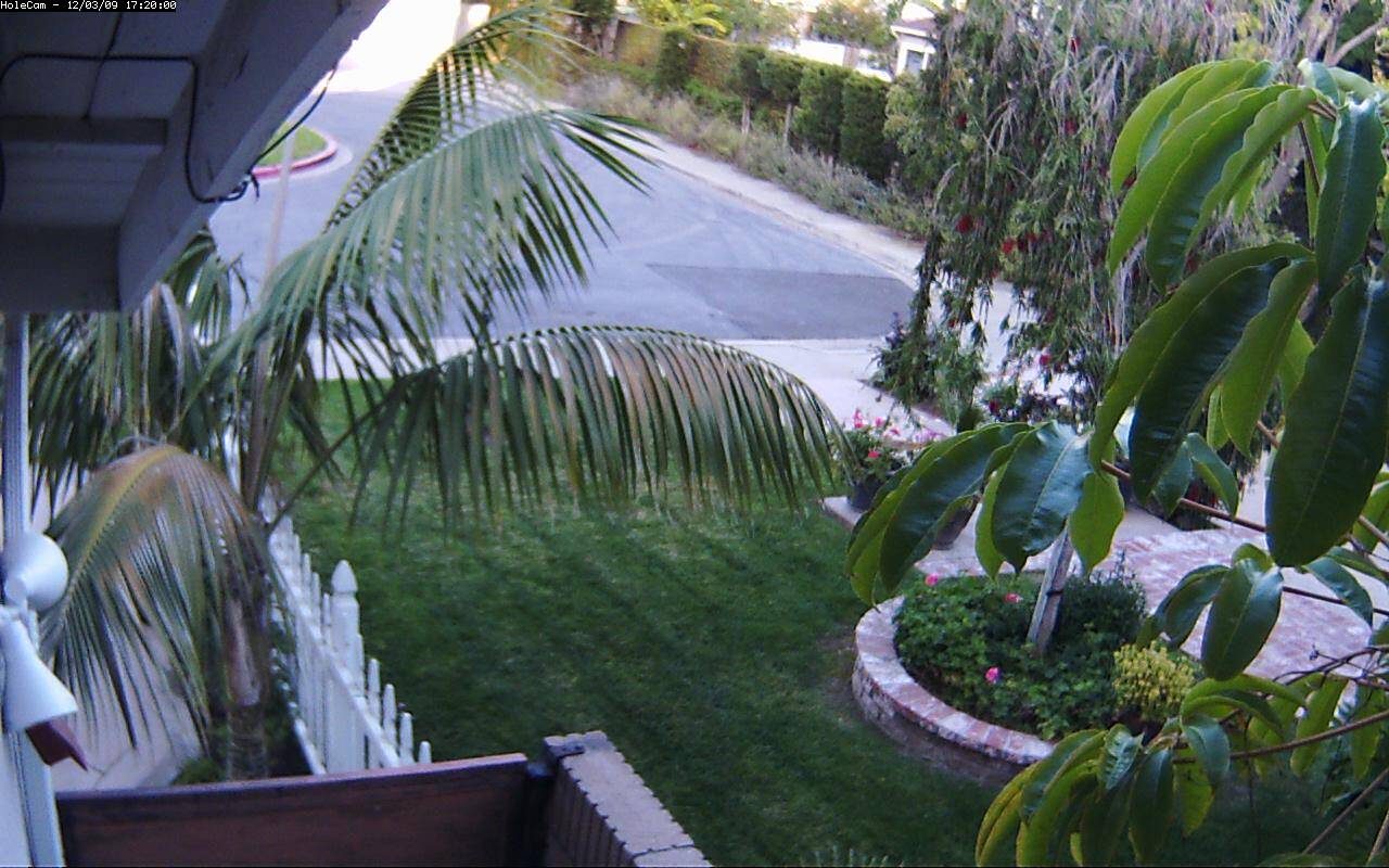

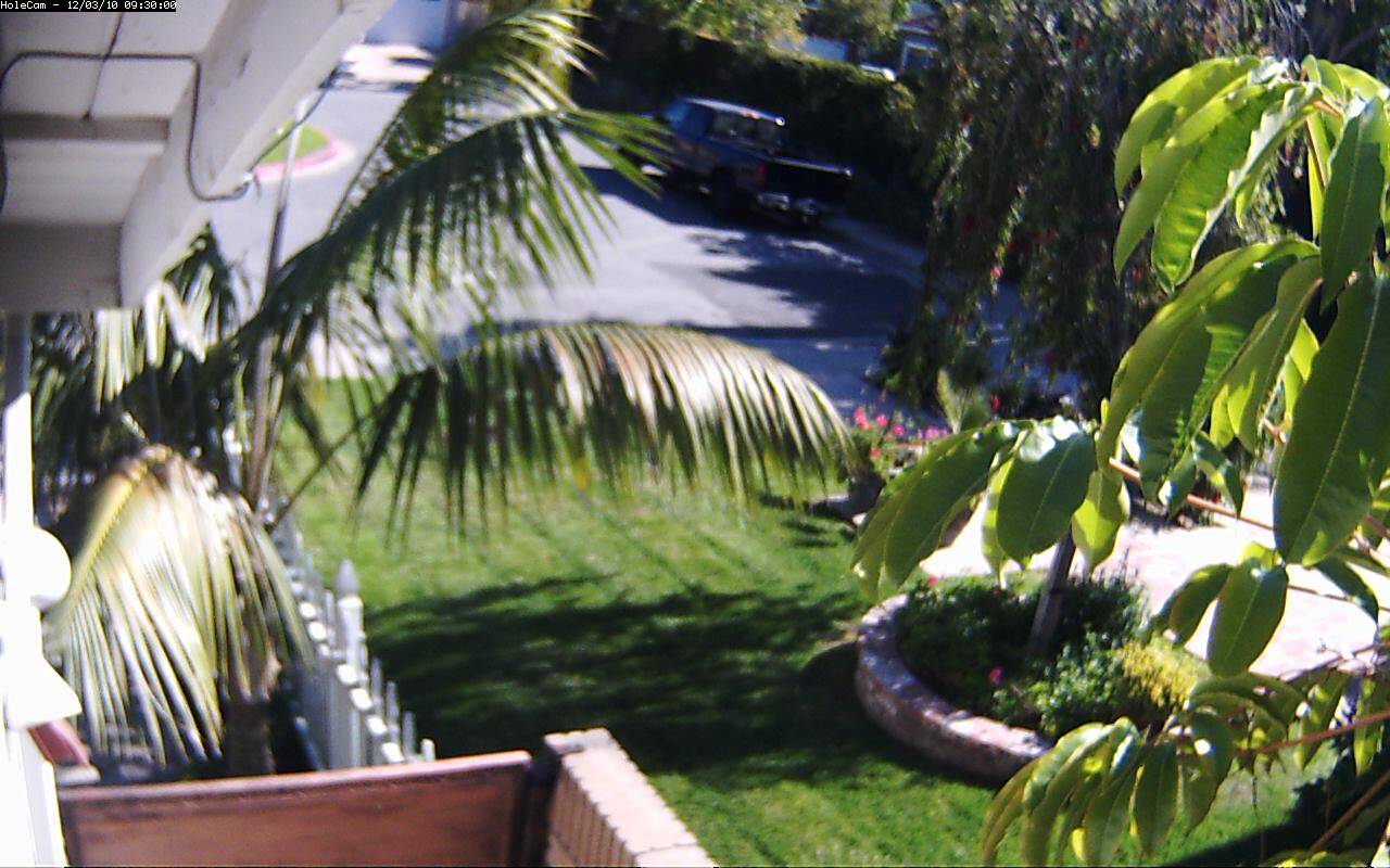

dvarapala 0 Posted March 10, 2012 And only partially out of focus at that! I bought a (relatively) cheap Vivotek FD8134V to watch the side gate to my back yard. All was fine at first, but after a week or so I noticed that the image was blurry (except for the plants to the right, which are closer to the lens). This blurring (near-sightedness?) only happens during part of the day; at other times the focus is much better: The camera is mounted in a spot where it's in full sun during the morning hours; this period roughly corresponds to the time when the focus is most blurred. Presumably the sun is heating up the lens or other interior components, causing them to expand and shift the lens relative the image sensor. Am I asking too much of this camera to have it operate in direct sunlight? Note that the sun does not shine directly into the lens, so the picture is never washed out by glare. My Axis dome was in full afternoon sun for over a year with no issues. Share this post Link to post Share on other sites
Soundy 1 Posted March 10, 2012 It's entirely possible for this to happen. If it's a standard M12 lens, the focus isn't actually fixed; the lens threads into the lens mount and focus is adjusted by turning the entire lens, moving it closer to or farther from the sensor. In most cases, the lens will be pre-focused at the factory, then locked in place with a small setscrew, although a few designs use a spring around the lens barrel to maintain tension on it. In your case, it looks like the lens mount itself might be loose, and one corner of it is pulling away from the camera board when it heats up, thus moving one side of the lens away from the sensor. Or it could just be some "play" in the lens threads allowing it to move with the temp changes (especially if it IS spring-loaded). Share this post Link to post Share on other sites
3RDIGLBL 0 Posted March 10, 2012 I've installed a number of these and have had to send back two so far. One camera was taking down my POE switch, power non Poe and switch worked fine but turn on Poe to that camera and switch shutdown. New camera was fine. My second camera had focus issues. The camera was an interior 8134 and one side of the picture could never come into focus. I would turn the small lens and the left side would be clear but the right was blurry and vice-versa. New camera fixed that one as well. I would say this one would have to be returned. Share this post Link to post Share on other sites
SEANHAWG 1 Posted March 11, 2012 But why is it focused during some parts of the day and not others. His 2nd image looks really sharp. Share this post Link to post Share on other sites
Soundy 1 Posted March 11, 2012 But why is it focused during some parts of the day and not others. His 2nd image looks really sharp. Read my second paragraph above. It's also possible that the lens element itself is just cheap plastic heat changes are affecting its shape. Really, lots of THEORETICAL reasons for it... only way to know for sure is to disassemble and inspect the camera. Or... just send it back. Share this post Link to post Share on other sites
