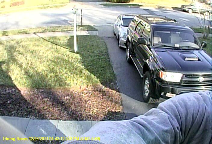

Had these on my computer and figured I'd share them. I recently replaced my Panasonic WV-CW484S analog dome camera with an Axis P3346-VE megapixel IP camera and had some day and night shots of each. Admittedly, the Panasonic definitely could've used a bit of tweaking and adjustment, but I didn't want to fuss around with it before uninstalling it.
Enjoy the screenshots anyways. You can click on them for the full resolution to see the real difference.
Day time Panasonic:
Day time Axis:
Night time Panasonic:
Night time Axis:

The Axis is clearly much better, night and day! This is a very good example of what each side has to offer, considering price as well. What kind of frame rate do you get with the Axis cameras? Is it just me or does the Axis seem out of focus at night?

Yea, one of my biggest concerns was that if I went megapixel, my night time performance would get worse. I was shocked to see that it is now MUCH better, night and day.
It could use some adjustment, but that post light in the front yard really messes things up for me and makes it difficult. I need to do something about that. The image is still very usable, though.

From my experience the whole "analog is better at night" thing only applies to 1st generation and low end MP cameras, and is way overplayed. These are some great comparison shots.

Agreed. There is a solid reason why this is THEORETICALLY the case - more pixels in a given sensor size means smaller pixels with less ability to collect light. However, as is the case with analog, there's more to low-light performance than just the pixels; otherwise a $30 eBay cam would look just as good at night as a Monalisa cam.
To me, if you're comparing differences without a person in different spots in sample picures, you're only comparing how nice a picture looks- especially at night. I'd guess a good MP cam would provide an improved ID shot at night as well, provided the lighting is appropriate. But that's only a guess. I only ever see pictures comparing scenic views, not what any one camera will provide for ID'ing purposes. That requires humans photograped by the cameras at different points in the field.

Specifically talking about the night shots here, no matter what camera, and for all the fiddling, it's the difference between setting it up for a good picture or setting it up for the best shot at ID'ing, imo. I'd simply walk out to those cars and act like I'm lurking and looking in them. Pull on the door handles. Walk around them just as someone would do who might be looking to bust into them. What you see [or don't see] would tell you where your lighting deficiencies are, that's all. I don't discount myself from this either. My analog camera pictures aren't all perfect for ID'ing yet either. But all too often I see noodling to dial in good pictures. How well that picture catches a thief could be another story. Dial in settings for the targets is all I'm suggesting.
Btw- I think the panisonic day shot was very good but the night shot was not good at all. I would have liked to see what that camera produced with a little fussing. The Axis is fantastic in the day shot and good at night. What anyone would look like when they peer into the passenger window at 3am with their backs to the lawn lamp remains to be seen though. Damn lamps are tough to deal with. I deal with one too. I've tried to just keep it out of the frame for the time being, but something will have to be done in the end.
