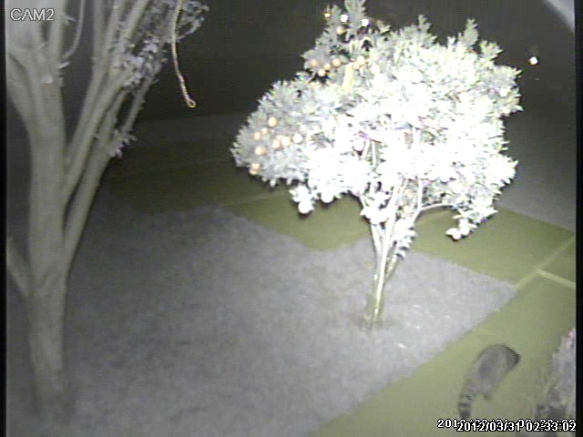

One of the reasons we put this camera setup in place was becuase we were pretty curious who was coming by and digging up our roses, and whatnot.
We've always suspected raccoon/skunks, but we were never 100% certain.
Well, we are today!
I fixed it up yesterday, put everything in place, camera 1 picked up some strange little guy with white in his eyes (probably just the camera), as he crossed the middle of the two cameras, light sensors picked him up and on came the lights. Camera 2 then caught him walking towards the front door and into the rose area... That's where it stops because we've yet to install the last two cameras! Out of sheer laziness, I suspect..

The double stamped time & date, is because when I took the snapshots, it wrote another time and date over where the camera recorded it.
I guess from now on I will ask it to be snapped bare, that way it will have the original time/date the camera embedded.
