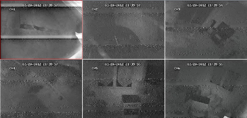

i have a problem with a cheap CCTV configuration in my house.
i have installed 6 CCTV cameras with rj45 cable and balluns, a dedicated power supply 12V 150W and a digital recorder for CCTV with a lan access and a 2To hard drive...
when i have installed all of that, that was perfect ! good captures and no parasites.
but after 6 months....
argh !
can you help me to solve this problem ?
i have ettempt many test today:
change pal to nstc => the screen jump
change quality while desactivate many cameras and level up quality and framerate on only one camera => no change
remove the fan inside the vcr (maybe it cause parasites) => no change
remove the hdd (power supply + sata) => no change
plug only one camera => no change
when i plug a playstation 1 to the vcr, nothing appears (maybe too high resolution...)
when i plug a camera to a little 36cm TV, camera appears with a great quality !
my problem appears to be the recorder... but 100€ in the wind ... argh !

Maybe your 12V 150W power supply is faulty. Try connecting one camera to the recorder (use coax for this test), and use a different supply.
From your pictures, it looks like the video signal is very weak and noisy. It might be a problem with your 12V supply, or your wiring. Maybe it is the recorder.
Has anyone moved a computer, monitor, or TV near your recorder or camera wiring? Maybe you are getting interference from this?
but when i plug them on a tv, no parasites...
if it's the power supply, they should be here
(the tv, for the test, is near to the vcr in a special 19" bay without sector parasites, same as all cables and 12v power supply for cameras and vcr)
i have does the test with a new power supply only for the dvr...
it appears better.
i'll look during a week if it's constant.
