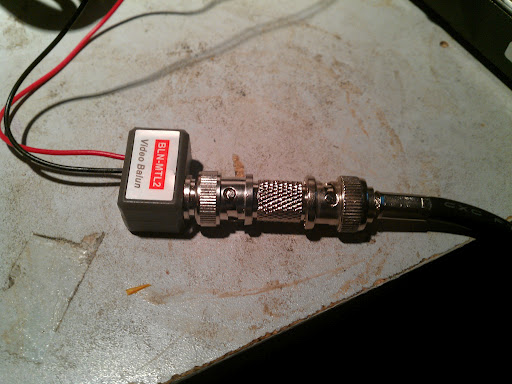

Your RG59 should not terminate with a balun. It should terminate with a BNC that connects to the balun on the UTP... like this:
Make sure you're only using a single pair of the Cat5 into the baluns, too - for example, white/blue to +, blue to - .
