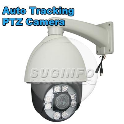

This is the one I settled on-
1/4 inch CCD Security CCTV Speed Dome Camera, EFFIO 650TV Line Horizontal Resolution, 0.01Lux Minimum Illumination, 27X Optical Zoom, 3.2 to 86.4mm Lens, 752 x 582 Effective Pixels, 360 Degrees Continuously Pan Angle, 8 Privacy Zones, 220 Preset Positions, With RS-485, Support Pelco-D, Pelco-P, HS, Built in Heater and Fan, 8PCS LEDs, 100M IR Distance, IR CUT, Auto Tracking Function, IP66
There are a TON of these types out there, but this one is better specd than most of them. Will this one be just another piece of crap? Don't say either way, you may jinx it.
