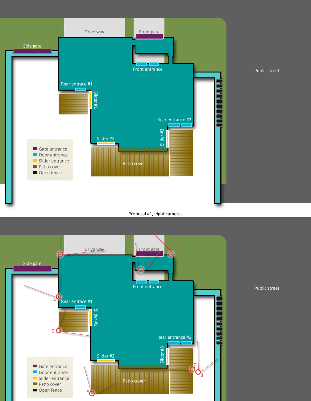

Would really appreciate if someone can review and critique my design:
I currently have the following equipment (new):
- 8 Channel DVR
- two (2) 3.6mm outdoor IR CCTV (420L)
[ looks similar to this http://www.amazon.com/dp/B003DZ6PQ2 ]
- two (2) 16mm outdoor IR CCTV cams (not sure of resolution)
[ looks similar to this http://www.amazon.com/dp/B000X9QD22 ]
I am looking to add 6 more cameras and would really appreciate any recommendations. I find the 16mm cameras have too much zoom
for my needs, hence looking to use eight 3.6mm cams. This is for a residential installation on a corner lot.
The lights I have around the property are all Dusk-Dawn enabled. Meaning, 50% lit from Dusk-Dawn and when motion is detected, the light source becomes 100%.

hi,it seems your design is good.
I think there is no need more 16mm lens,the view angle is too small,only 30 degrees.
as far as i know.3.6mm is the widely used one,90 degrees,2.8 is 120. 6mm is 60.
Hope this may help.

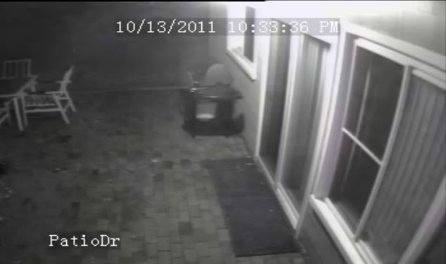

In the general analog forum in the 'analog video samples' on page 5, I posted a bunch of pictures from my cameras. I also have some vids in my signature. Maybe that will help you some.

Do you think this camera would be a good candidate for locations (2,5,6,7) of my diagram?
What cameras would you recommend for the other areas?

They'd actually work well in all your locations. The only consideration for something else might be in areas of complete darkness, as they work great with very little light... my preference in that case, though, would be a motion-activated flood light rather than a camera with built-in IR. Even an external IR illuminator would be preferable.

Actually, lighting is adequate at all entrances of the house. How would this camera work if ambient/flood lights are pointed directly at the camera?
Updated drawing with ambient light/motion activated flood lights. Camera 5, 6 & 7 may have partial lighting directed at the camera.
NO camera will be happy with lights pointed directly at it (at least not directly at the lens)
Doesn't look too bad... I assume the light will mostly be facing down and the cameras mounted relatively high - as long as you don't have bright light shining directly into the lens, you're okay, although the backlighting will mean you don't get much more than a silhouette of a person.
What I suggest is motion-activated lights mounted close to the camera - think about it: if you're creeping around in the dark and a bright light snaps on, what's your automatic reaction? You want to see if you've been spotted, so you look toward the source of the light to see if there's someone there. If there's a camera near it... bingo! nice, clear, well-lit face shot.
If I have cameras 5,6 and 7 mounted in the adjacent angle, right below the light source, I would need at really wide view? Would this be a better option?
Your camera placement seems not great overall to me. What I'd consider adjusting-
Cam 1- either center the camera to cover the driveway, or move it to the opposite side and shoot from the opposite direction. I'm guessing you park your car regularly on the side closest to your front entrance. You want the camera to be closest to the car. You don't want the car to be in the furthest position of the fov. Aside from your home, your car is the second biggest asset to be broken into, stolen, or vandalized. In most crimes of opportunity, it's actaully the first thing to be messed with. So help your camera help you ID someone at the car- locate the driveway camera where it puts the car up front in the fov, not at the back.
Cam2- That camera should be getting the ID shot of someone at the door. If in that fov you can get a side swipe of the doors as well, all the better. Such as this shot I get from my front door-
The reason I prefer the side shot is because I get face ID from anyone entering AND exiting, as well as seeing if my front door is open. For you, let camera 3 handle the front gate. Make camera two see your front door entrance only.
Cam 3- position is fine so long as you confirm the security light [dim and bright] doesn't cause a bad picture. Security lights can be framed just out of the fov, still throwing light but not looking right at the light. Be it framed above the shot or to the sides, so long as it's just out of frame it can help. Doesn't always have to be a mile out of frame to work ok.
Cam 4- Ok, but same thing- make sure lights don't affect the picture. If so, you have room to move that camera around.
Cam 5- Tough shot. I'd pick the real target as being the slider. The other door I figure is solid and tougher to bust into. The slider is more vulnerable, therefore make that the money shot even if it means sacrificing a decent shot of the other door. That camera needs to be on the house looking sideways or down on that slider. Avoid cameras looking INTO spaces, where all you'll get is a shot of someones back. Generally, you want them pointing so they'll catch full on face or profile.
Cam 6- Again, your placement will only catch someones back. So, facing the slider from the outside, mount the camera on that corner of the HOUSE next to the door. Point it so you get a nice shot of the slider and a long shot of the patio. I'll bet you can frame the shot so the light is above and out of frame, such as this, where the light is up there but just out of frame-
Cam 7- Facing the slider from the outside, mount that camera on the HOUSE on the corner next to the slider. That will give you a perfect side shot of the slider and rear entrance 2, all in one shot.
Cam 8- I would mount that camera all the way down to the front end of the house pointing towards the backyard, catching the property from front to back direction on that side. It puts it closer to the open fence as well.
Food for thought. Good luck to you.
