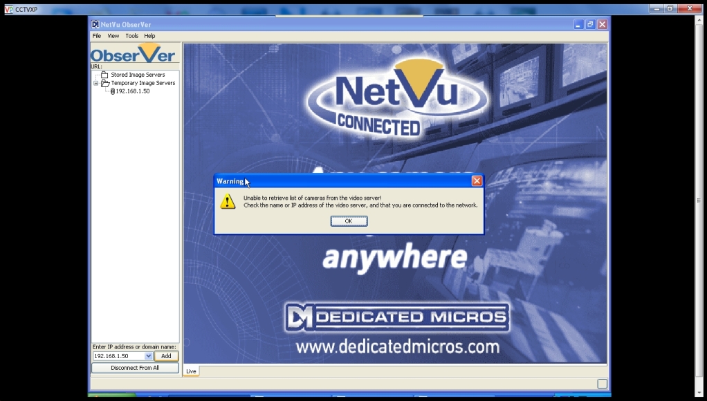

deeco 0 Posted March 30, 2012 Hi, i am pulling my hair out as i cannot connect through netvuobserver to a DS2 DVRT dedicated micros unit i can connect through viewer and network admin, do i need to upgrade firmware? current version is 3.1 (090) -netdvtr ids this compatilble , according the DM site it is........ Exact error after login with credentials in netvoobserver is "unable to retrieve list of cameras from the video server! check the name or ip address of the video server, and that you are connected to the network Share this post Link to post Share on other sites

deeco 0 Posted March 31, 2012 this is the error accepts username and password then connects, this is over LAN Share this post Link to post Share on other sites

groovyman 0 Posted April 4, 2012 Oh - that's an older model. I have a few of those out in the field, but they are the D4 models, not DS2. Unfortunately NetVu Observer won't work with it (I didn't realize from the model number, sorry). I can't find a smartphone app that can connect to it either. The options are what's on the page - Network Viewer or Web Viewer (and the PC Playback software). A note about the software - it doesn't seem to work on 64-bit Windows. 32-bit works fine though. Best bet is to run it on an XP system. Anyway, you can stop pulling your hair out. Share this post Link to post Share on other sites
