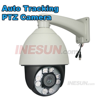

shockwave199 0 Posted March 31, 2012 This is an odd one, at least to me. So, I got my ptz and the female power end on the camera will only fit the cameras power supply, not the male end of my bnc/power cable. It looks like it should fit. I mean it's gota be a just a hair off somehow, but I tried- no go. The camera is a chinese camera and so is the cheap premade bnc/power cable I'm using. Aside from cheap, chinese into chinese and no fit?! The power supply for the camera does fit the bnc/power cable, however, and of course straight into the camera as well . It's Just the cameras female end itself not fitting my power connection from the cable. DOH! Any ideas? I mean, I could run power right out to the camera, but I was planning on a 25' bnc/pwer cable running into the house and powering it from that. Share this post Link to post Share on other sites

tomcctv 190 Posted March 31, 2012 Yep- barrel ends and this is a smidge off, just like you explained. Never ran into this with ANY barrel ends on anything. Weird. hi shock. we had this problem last year with a guy who bought his own PTZ. he also cut power cable and added stander ends and it would not work. what we found was the camera is very low powered both in volts and amps and will only run on local power. i think if you look at your camera spec it will be 12v 350ma ..... this is too small to use extended cables over a distance. Share this post Link to post Share on other sites

shockwave199 0 Posted March 31, 2012 The power supply is- AC adapter Input AC 100-240V~0.65 50-60Hz/ Output DC 12V 0-4A I only have a price/buy link, not a spec link. Share this post Link to post Share on other sites
tomcctv 190 Posted March 31, 2012 Output DC 12V 0-4A hi is this your camera ??? spec is 4 amp in total so yes running it at a short distance sould be fine. i would do just as soundy says ... chop plug off power supply and attach it to the camera end over cat5 so you get video power data and alarm. Share this post Link to post Share on other sites
