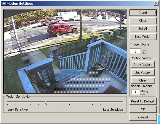

In my case the attached picture shows about 20% of the FOV is covered because it is all I need on the front door/porch area. But, the side of the house faces a large parking lot with constant traffic and drug deals. I have resigned myself to switching both of them over to record 24/7 so I don't miss a trick. On one of them I set it to record on motion as well. This takes up more hard drive space since it creates 2 files on my 4 Ch Dahua but, then again, I have a 1TB drive in it so it isn't a big deal. The good part of that is I can search for motion only and let it ride. This is handy for playback over night to see if anyone messes around near our cars.

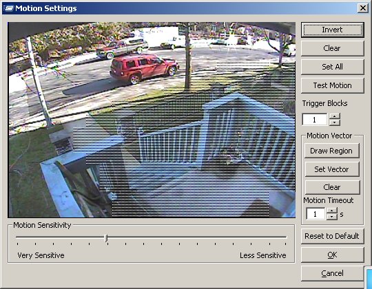

When you're defining motion areas, BTW, keep in mind that you don't generally have to cover an ENTIRE area where something will be. In the case of a door stoop, for example... say you want to detect when someone is at your door. You could do this:
...but that's going to also detect anyone walking up to the stairs or along the grass at the bottom of the stairs or even a bird or squirrel on the porch railing.
Or, you could do this:
Because anyone standing at the front door, is going to be standing in the marked area, and you're still going to pick them up. Remember, you don't have to detect the ENTIRE object... you only need to detect SOME change within the area of interest.

That is indeed a Vigil - the "Motion Alarm" section adds the extra "Motion Vector" settings that lets you define two areas and a direction of motion to trigger on - for example, to trigger on someone going up the stairs, but not down the stairs.
