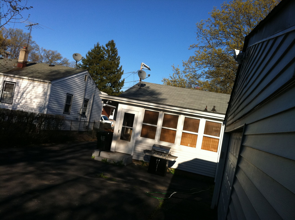

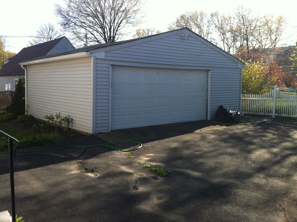

alec.mc 0 Posted April 7, 2012 I took a little hiatus from working on my cam system, and im trying to fine tune what I have here. ( revo 16 channel system, with various revo bullets and domes ) I want to place a camera at the peak of my detached garage ( dome maybe? ) to over look my rear driveway and backporch area. Im thinking a dome might be more aesthetically pleasing, I dont want it to stick out like a sore thumb. Also, it will be exactly directly above a motion detction flood lights that light up my drive way, Im also thinking about upgrading to a light that is always on from dusk till dawn ( timer ). Im not sure if having the camera sort of directly behind / above the light will work in my favor , or make it more difficult. Another option would be the rear most low part of the room ( where I took the 2nd picture from ) Should give me a better view of the whole driveway, unless the cam choice for the peak of the roof above the light has such a wide angle it gets everything. What would you put there? Budget 100-160. Either RJ12 connections, or BNC Here are pictures: Share this post Link to post Share on other sites

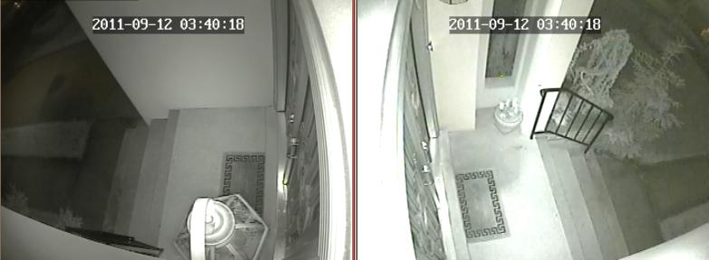

nDAlk90 0 Posted April 7, 2012 What do you think of this camera? Here is a quality comparison with this Sony 700tvl Effio dome camera vs. a Sony 520tvl Had dome camera. Left: 700tvl Sony Effio Right: 520tvl Sony Had Share this post Link to post Share on other sites

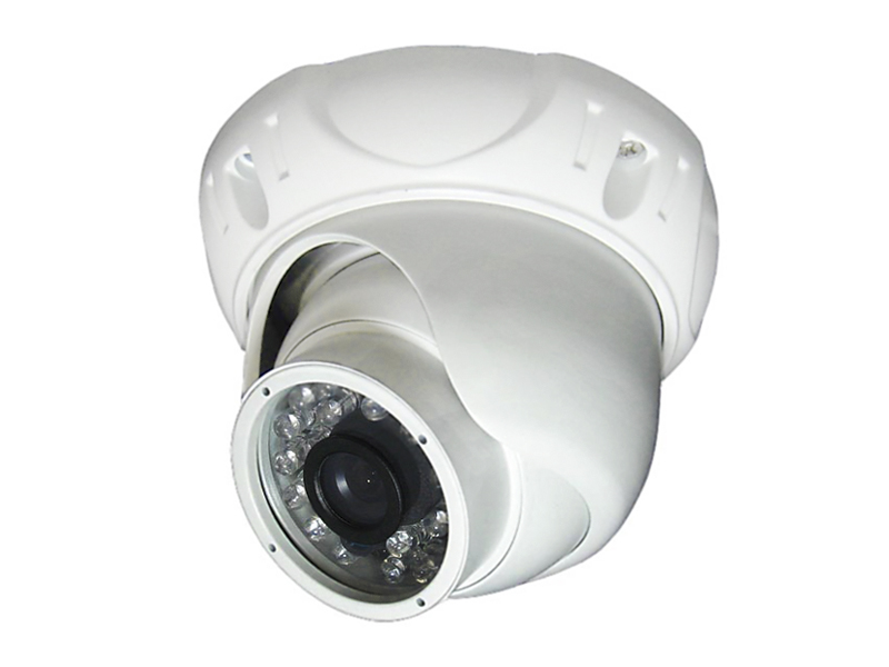

Soundy 1 Posted April 8, 2012 At the risk of sounding like a broken record: CNB VCM-24VF Share this post Link to post Share on other sites

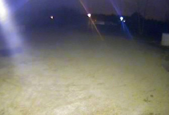

shockwave199 0 Posted April 8, 2012 Be careful installing domes near security lights. This is a prime example of how a picture can go wrong with a security light overhead- and it's not that close but it still causes problems- The harsh light top left of frame is a security light on a peak and the dome is a good deal lower. Just be careful not to ruin your shot. I would go with a lower placement such as your second picture. The CNB would do well for you but your sony effio eyeball would probably do well too. Choice is yours. Good luck. Share this post Link to post Share on other sites
hey_moe 0 Posted April 8, 2012 I have to agee with soundy here. I just ordered another one which now I have three of these on my property. For the price it has both outstanding day and night time pictures. I am still a newbe but and still learning but I can't see where you can go wrong on that CBN camera. Share this post Link to post Share on other sites
