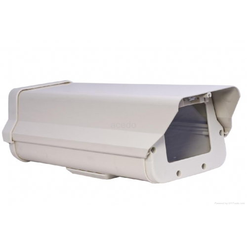

Technical aspects aside, a box camera does need an additional enclosure if you want to use it outdoors, and domes CAN be much more vandal-RESISTANT (there's no such thing as vandal PROOF). So in the end, the main choice comes down to aesthetics, where you want to use the camera, and whether you need to use more specialized lenses.
