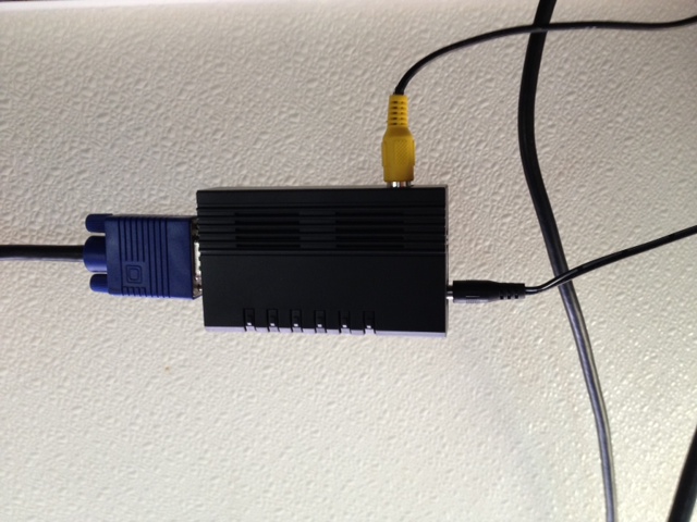

LillDragun 0 Posted April 14, 2012 I have a hard time spending $300-$400 on a 17in cctv lcd screen. So how would this work out?: If I get the T-splitter you mentioned in the post above, split the video feed from the camera before it goes into the DVR, run one split into the BNC to VGA converter and one into the DVR input, and then from the converter run a VGA cord into the monitor. Would that give me the static live feed of that one camerathat I am looking for? BNC to VGA converter OR the current setup with the monitor at the drive thru area has a monitor connected to what I can only assume to be a composite video RCA to VGA converter from the converter box, the BNC cable runs to where the old DVR was and was connected to the BNC output, which fed to drive thru screen what my office screen showed. I want the drive thru screen to be a live static feed from one camera. If I keep the current setup and put a T-splitter between the camera and the DVR would that give me what I want? did any of that make sense? Share this post Link to post Share on other sites
Soundy 1 Posted April 14, 2012 did any of that make sense? Not really, but I get the gist So if I follow: your office screen connected to a VGA or HDMI output from the DVR, and the composite out from the DVR runs into the VGA converter to then feed the drive-thru monitor, so both have the same display. If that's the case, you can leave the existing setup in place... add the T-splitter to the incoming camera feed, and send it to the DVR input, and to the converter box, and that should be it. IF you're replacing the DVR, though, check for a "spot" output - if it has that, that gives you the ability to send a specific camera (or usually, a sequence of cameras) to the output independent of the main screen. It would be preferable to hook the adapter box to that, not only because it gives you the ability to control what camera goes to the drive-thru screen, but splitting the camera signal WILL cause a minor drop in quality, while using the spot output will not. And again, if you get a DVR with loop-through inputs, you can run the camera into the DVR, and then back out from that camera channel to the monitor, which also avoids the quality-loss problem. Share this post Link to post Share on other sites
LillDragun 0 Posted April 14, 2012 Almost. I almost understand the part on the getting a DVR with the loop through or spot output, but I'm now kinda having trouble understanding the difference between the two. as far as the setup i have, I have 8 cameras installed, BNC wires running all into my office. One LCD monitor inside my office to view the DVR, and one monitor in the drive thru area to monitor the camera that watches the drive thru. The monitor at the drive thru needs to have a live static feed of the ONLY the drive thru camera. I DO NOT want the monitor at the drive thru to have the same display as the office. If I am in the office doing a playback or watching a single screen to watch an employee, I do not want the drive thru to see that I am watching someone. So, the drive thru needs to stay static on the drive thru camera. does that clear things up? Share this post Link to post Share on other sites
Soundy 1 Posted April 14, 2012 Oh yeah, I totally understood what you need to do, it was just your description of the setup that was sorta random - took a couple read-throughs to get it. Spot output is a separate output on most DVRs that let you display any one camera independent of the main output. Some also allow you to configure a sequence - so for example, if you had one camera watching the menu board, and another on the entrance to the DT lane, you could have it flip back and forth between them. Loop-through means each input also has its own output that sends that channel back out - many DVRs have this, but not all. Either of these would give you a way to send the single camera out to a separate monitor without splitting the camera feed. The splitter will work, but again, potentially with a small drop in image quality... so if either of the other two methods are available, they're preferable. If not though, not the end of the world. Share this post Link to post Share on other sites
LillDragun 0 Posted April 14, 2012 Okay, all that being said, is there an 8 channel DVR that you can recommend that has those type of features? Image quality isn't that big a deal for the drive thru, the worker doesn't need to see how symmetrical the customer's face is, just be able to see that there is someone there, in the case that the headset malfunctions. If I can just slap a T-splitter an be done with it then the Proline-8 will be just fine. Share this post Link to post Share on other sites
