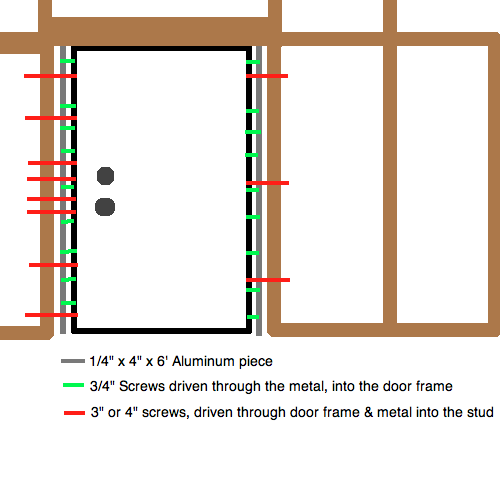

nDAlk90 0 Posted April 12, 2012 Many of us install security cameras, alarms, etc. But how many of us reinforced the frame of the door? What steps have you taken in protecting your front door? Share this post Link to post Share on other sites
fa chris 0 Posted April 12, 2012 Doors are easy to kick in, most have small strike plates with a deadbolt which rips right out of the frame or the deadbolt rips right out of the door. This is really the only thing you need to defend against. Use a deadbolt and replace the strike plate with a 12" plate, use long screws and get it deep into a stud. Reinforce the door with a wrap around plate like this: http://www.homedepot.com/h_d1/N-5yc1v/R-100163752/h_d2/ProductDisplay?catalogId=10053&langId=-1&keyword=door+lock&storeId=10051 Makes it a whole lot tougher to kick in and a pain to pry. Share this post Link to post Share on other sites

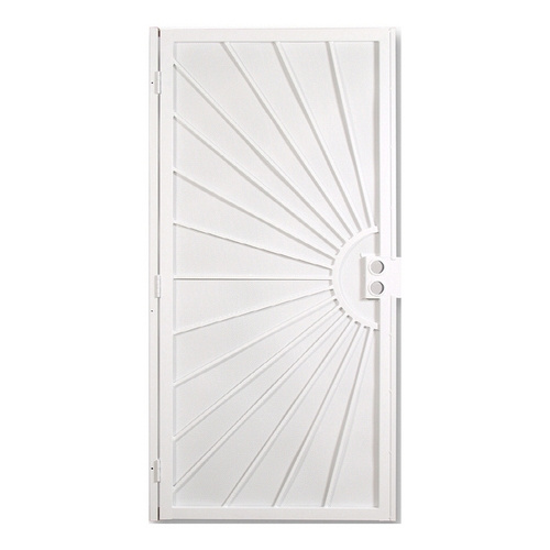

myplace46 0 Posted April 14, 2012 xellbuy said: This is how I take care of the problem. Heavy steel frame screws onto the existing wood frame, swings outward so it can't be kicked in. I can build these in several styles. I make security bars for windows too. Share this post Link to post Share on other sites
