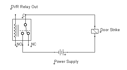

I would be using a digimerge DH200+ which has a programmable NO/NC alarm output relay which I can operate manually from a remote site.
Since it does not supply power to the strike how would I release it since my strike would require 12 or 24 volts. Should I use a magnetic lock?

Just think of the relay output as a computer-activated pushbutton - you'd wire the strike as you normally would with a power supply and trigger switch, except you wire the relay contacts in place of the switch.
Use something like this: http://www.rutherfordcontrols.com/products/electric-strikes/4-series/ - get one that's fail-secure (meaning it's locked when NOT energized), then wire it through an NO contact. When the contact closes, the strike is energized, and unlocks. Remove power, and it's locked again.
